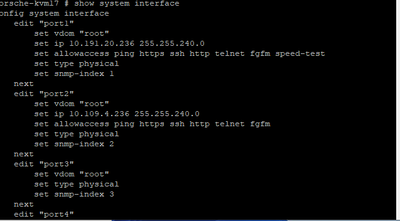

Configure a local-in policy to deny all traffic to an internal interface:
config firewall local-in-policy
        set intf "port2"
        set srcaddr "all"
        set dstaddr "all"
        set service "ALL"
        set action deny

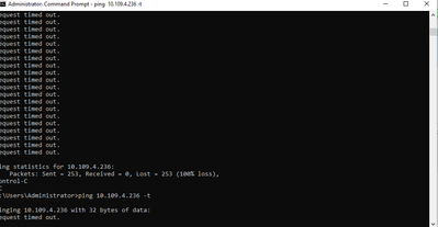

From a client, test unicast traffic (e.g., ping the FortiGate). The ping fails, confirming the local-in policy is active.

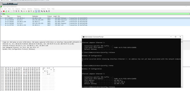

From the same client, request a new DHCP lease. The client still receives an IP address.

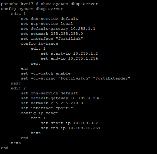

Disable the DHCP server:
config system dhcp server
    edit <ID>
        set status disable
Delete the DHCP server configuration:
    delete <ID>
The following shows the command and output to identify the DHCP server ID.

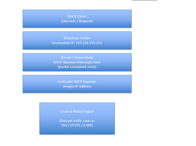

Packet flow diagram:
Unicast traffic like SSH/HTTPS/ICMP reaches here. However, DHCP broadcasts never reach this stage.
