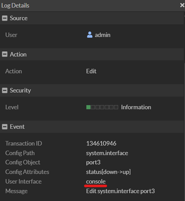

In this screenshot, the change was made from the Console port of the device, and the Port3 status was changed:

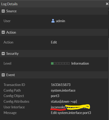

In this screenshot, the change was made from the JavaConsole (CLI console in the GUI) of the device, and the Port3 status was changed:

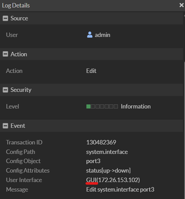

In this screenshot, the change is made by accessing the GUI of the device, and the Port3 status was changed:
