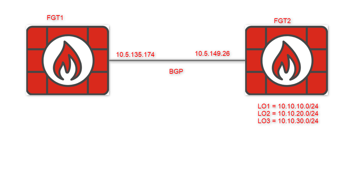

In this example FGT2 advertising 10.10.10.0/24, 10.10.20.0/24 and 10.10.30.0/24 prefixes to 'FGT1'.
Instead of configuring the three network prefixes, an address group is configured on 'FGT2' to announce the network to BGP.

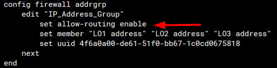

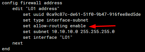

To achieve this needs to enable the allow-routing setting in the firewall address and address group. By default, it is disabled. Enable this setting for all firewall addresses that want to advertise. Here, it is shown only for one firewall address.

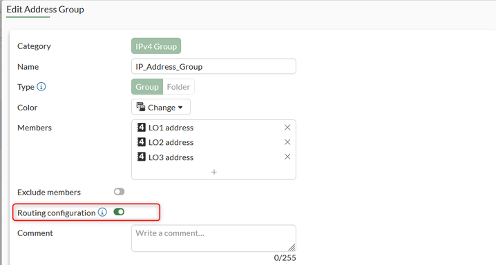

FortiGate Firewall Address Group in GUI :

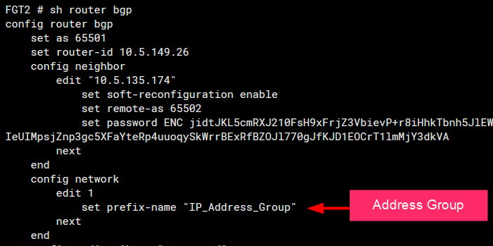

Configure this address group in BGP:

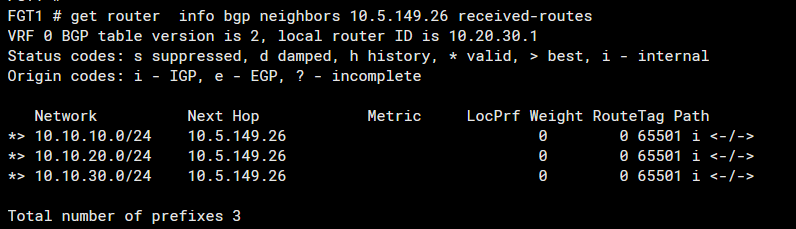

'FGT1' receives all three prefixes announced with the address group 'IP_Address_Group'.
