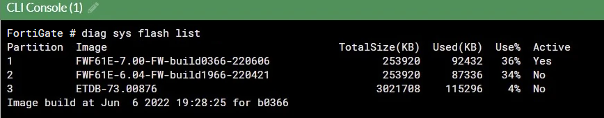

An alternative way to confirm the firmware version would be from the backup config, the first line consists of the firmware version along with the build number such as '#config-version=FGT-7.0.15-FW-build0632-240403:opmode=0:vdom=0:'.

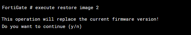

Use the following command to restore the firmware held in partition 2:
The device will reboot and load the previously selected version.
