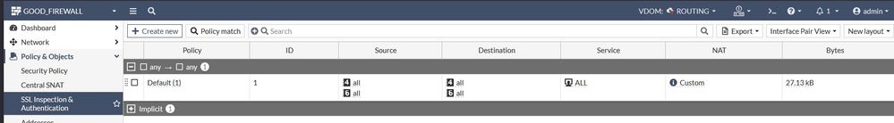

Disabling hardware acceleration is one of the recommended steps while troubleshooting various network connectivity issues. In order to perform this on a profile based firewall, it is important to track which SSL Inspection & Authentication policy this secure firewall policy is hitting. Usually for the users that are not that familiar with the policy based mode, the policies look like the picture below:

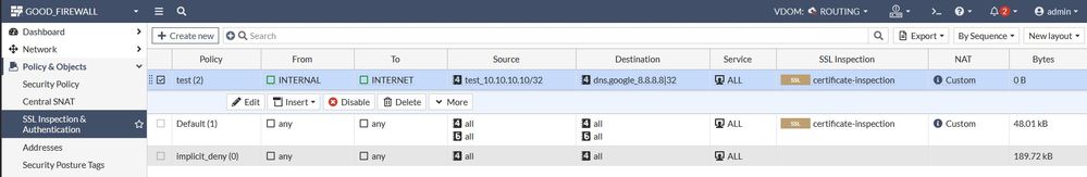

It is not recommended to disable the auto-asic offload on this firewall policy, therefore a new policy should be created with the parameters that are troubleshooted and the policy should be edited in cli.
After the creation of this policy, edit in cli and "set auto-asic offload disable":
