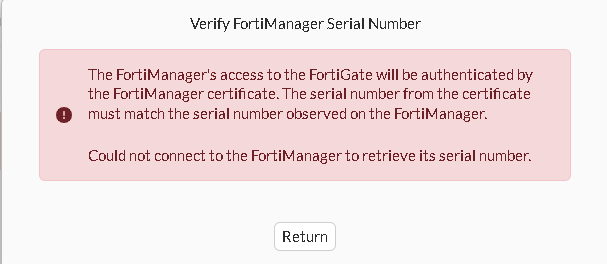

The following error is observed on the FortiGate, even though FortiManager is not used.
Message:
Verify FortiManager Serial Number
This happens because the central management was set to type FortiManager.
