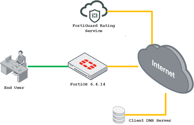

The next outputs and configuration will rely on this topology.
The article will describe the path of a user-filtered DNS request through the DNS filter feature of FortiOS.

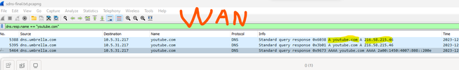

Here is a PCAP of the DNS server response, pay attention to the IP / hostname mapping.
Here is a PCAP of the DNS server response on the LAN side transmitted to the end-user.
Both 'A' records are different because the DNS transaction has been checked and categorized by the DNS filter feature.
