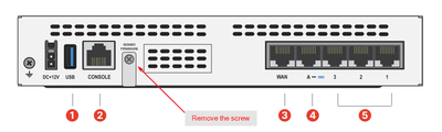

For the 50G series, the signed firmware cover is on the back of the appliance. The screw needs to be removed from the panel.
After the screw is removed, it will reveal a switch that can be set to Low [L] or High security mode [H]:
For the 70G, the signed firmware panel is also on the back.  The screw needs to be removed to reveal the switch to set Low [L] or High security mode [H].

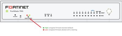

On the front of the 70G series, there is an LED to indicate whether the security mode is set to [L] or [H].

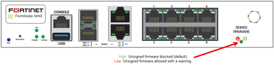

FortiGate-90G (Gen2) is Part Numbers: Pxxxxx-11-01 and above (see the FortiGate 90G quick reference guide).
On the front of the 90G (Gen2) series, there is an LED to indicate whether the security mode is set to [L] or [H].

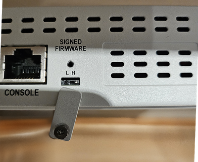

For the 120G series Part Numbers: Pxxxxx-2x-01 and above, both the panel and the LED indicators are on the front of the unit. The screw needs to be removed to access the switch to set the security mode to [L] or [H]. The LED indicates the current mode.

For the 200G series, similar to the 120G, both the panel and the LED indicators are on the front of the unit. The screw needs to be removed to access the switch to set the security mode to [L] or [H]. The LED indicates the current mode.
