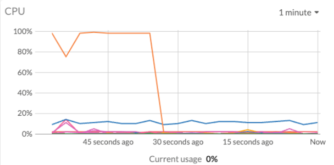

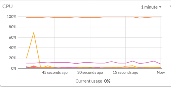

Description This article provides a solution for an issue where the 'cmdbsrv' daemon on FortiGate devices experiences high CPU utilization (85% to 90%) for approximately 11 minutes after a reboot leading to temporary performance issues.
Scope FortiGate v7.6.1.
After rebooting the FortiGate, the 'cmdbsrv' daemon exhibits high CPU utilization, typically between 85% and 90%, for about 11 minutes. Once this period elapses, the CPU utilization of the 'cmdbsrv' daemon returns to normal.
diagnose system top 2 50
10:53:26 AM up 0 days, 0 hours and 4 minutes
0U, 0N, 0S, 100I, 0WA, 0HI, 0SI, 0ST; 387709T, 361363F
cmdbsvr 9790 R 85.6 0.0 0
After 11 Minutes:
11:01:33 AM up 0 days, 0 hours and 12 minutes
0U, 0N, 0S, 100I, 0WA, 0HI, 0SI, 0ST; 387709T, 360582F
cmdbsvr 9790 S 0.1 0.0 0
This issue has been resolved in v7.6.3 (available in the support portal).
Another example is repeated and frequent CMDB_REQ_COMMIT requests that related to the 'cmdbsvr' process.
   diag debug reset
   diag debug cmdb-trace 1
   diag debug console timestamp enable
   diag debug enable
   diag sys top-mem 30
2025-04-24 10:05:26 cmdbsvr set_in_by_cmdbsvr
2025-04-24 10:05:26 cmdbsvr set_iprope
2025-04-24 10:05:28 cmdbsvr recv req_type=0(CMDB_REQ_COMMIT) from pid=18267(/bin/dhcpcd)
2025-04-24 10:05:28 [_svr_d_commit:2703] pid=18267, object='system.interface'
2025-04-24 10:05:28 [_svr_d_commit:2703] pid=18267, object='router.static'
2025-04-24 08:05:28 cmdbsvr starting: pid=18274, argc=1, argv[1]=''
2025-04-24 10:05:30 cmdbsvr set_iprope6
2025-04-24 10:05:32 cmdbsvr waiting for request...
2025-04-24 10:05:32 cmdbsvr set_in_by_cmdbsvr
2025-04-24 10:05:32 cmdbsvr set_iprope
2025-04-24 10:05:33 cmdbsvr recv req_type=0(CMDB_REQ_COMMIT) from pid=18277(/bin/dhcpcd)
2025-04-24 10:05:33 [_svr_d_commit:2703] pid=18277, object='system.interface'
2025-04-24 10:05:35 cmdbsvr recv req_type=0(CMDB_REQ_COMMIT) from pid=18277(/bin/dhcpcd)
2025-04-24 10:05:35 [_svr_d_commit:2703] pid=18277, object='system.interface'
2025-04-24 10:05:35 [_svr_d_commit:2703] pid=18277, object='router.static'
2025-04-24 08:05:35 cmdbsvr starting: pid=18284, argc=1, argv[1]=''
2025-04-24 10:05:38 cmdbsvr waiting for request...
2025-04-24 10:05:38 cmdbsvr set_in_by_cmdbsvr
2025-04-24 10:05:38 cmdbsvr set_iprope
2025-04-24 10:05:40 cmdbsvr recv req_type=0(CMDB_REQ_COMMIT) from pid=18286(/bin/dhcpcd)
2025-04-24 10:05:40 [_svr_d_commit:2703] pid=18286, object='system.interface'
2025-04-24 10:05:41 cmdbsvr set_iprope6
2025-04-24 10:05:52 cmdbsvr recv req_type=0(CMDB_REQ_COMMIT) from pid=18286(/bin/dhcpcd)
2025-04-24 10:05:52 [_svr_d_commit:2703] pid=18286, object='system.interface'
2025-04-24 10:05:52 [_svr_d_commit:2703] pid=18286, object='router.static'
2025-04-24 08:05:52 cmdbsvr starting: pid=18293, argc=1, argv[1]=''
2025-04-24 10:05:55 cmdbsvr waiting for request...
2025-04-24 10:05:56 cmdbsvr set_in_by_cmdbsvr
From the output above, frequent CMDB_REQ_COMMIT requests come from the dhcpcd process, specifically related to updates on system.interface and router.static objects.
These commits happen every few seconds, triggering cmdbsvr to commit changes repeatedly.
Each new PID indicates a new dhcpcd process instance, suggesting it's being restarted repeatedly.

To instantly remediate the high CPU utilization due to cmdbsvr, the process can be killed using the command below.
   fnsysctl killall cmdbsvr
