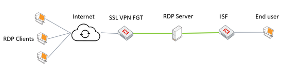

Let's assume that a network administrator has implemented the below topology:
The goal of the network admin is for external RDP clients to connect to the RDP server via SSL VPN and then to be able to perform calls via a VoIP solution to the end user.

  • In Web Mode, the FortiGate acts like a proxy server between the RDP Client and the RDP server, thus, the quality of the sound is hard to guarantee. Due to this technical limitation, audio propagation in SSL VPN Web Mode is currently not supported.
  • In Tunnel Mode, the particular goal could be achieved since an internal IP address from the configured IP pool is assigned to the remote external users and a direct communication channel between the client and the server exists.
