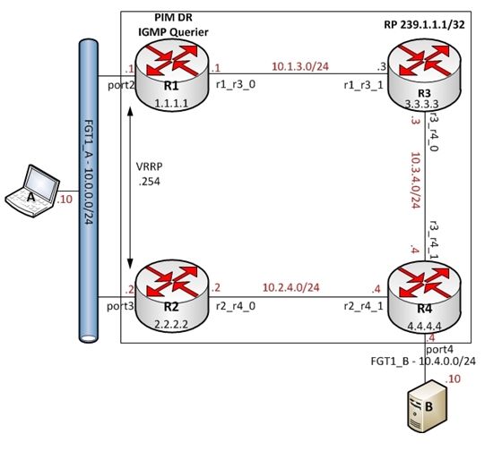

(R3) # get router info multicast pim sparse-mode table 239.1.1.1
IP Multicast Routing Table
(*,*,RP) Entries: 0
(*,G) Entries: 2
(S,G) Entries: 5
(S,G,rpt) Entries: 9
FCR Entries: 0
(R3) # diag sniffer packet r3_r4_0 'proto 103' 4 0 l
interfaces=[r3_r4_0]
filters=[proto 103]
2016-07-06 06:17:07.644360 r3_r4_0 in 10.4.0.4 -> 3.3.3.3: ip-proto-103 68
2016-07-06 06:17:08.639835 r3_r4_0 in 10.4.0.4 -> 3.3.3.3: ip-proto-103 68
2016-07-06 06:17:09.639791 r3_r4_0 in 10.4.0.4 -> 3.3.3.3: ip-proto-103 68
2016-07-06 06:17:10.642411 r3_r4_0 in 10.4.0.4 -> 3.3.3.3: ip-proto-103 68
2016-07-06 06:17:11.639761 r3_r4_0 in 10.4.0.4 -> 3.3.3.3: ip-proto-103 68
diagnose debug enable
diagnose debug flow show console enable
diagnose debug flow show function-name enable
diagnose debug flow filter daddr 3.3.3.3
diagnose debug flow trace start 100
2016-07-06 06:34:22 id=20085 trace_id=102 func=print_pkt_detail line=4478 msg="vd-R3 received a packet(proto=103, 10.4.0.4:0->3.3.3.3:0) from r3_r4_0. "
2016-07-06 06:34:22 id=20085 trace_id=102 func=init_ip_session_common line=4629 msg="allocate a new session-000056af"
2016-07-06 06:34:22 id=20085 trace_id=102 func=fw_local_in_handler line=385 msg="iprope_in_check() check failed on policy 0, drop"
(R3) # show firewall policy
config firewall policy
set uuid 4ab60d1a-435c-51e6-76b7-39c0c045e9e6
set srcintf "r3_r4_0" "r1_r3_1"
set dstintf "lo3"
set srcaddr "R4_Loopback"
set dstaddr "R3_Loopback"
set service "PIM"
(R3) # show firewall address R4_Loopback
config firewall address
edit "R4_Loopback"
set uuid 57546916-2bfd-51e6-c15c-a8f5ff213544
set subnet 4.4.4.4 255.255.255.255
config router multicast
set multicast-routing enable
config pim-sm-global
set register-source ip-address
set register-source-ip 4.4.4.4
filters=[proto 103]
2016-07-06 06:22:58.167509 r3_r4_0 in 4.4.4.4 -> 3.3.3.3: ip-proto-103 68
2016-07-06 06:22:58.167649 r3_r4_0 out 3.3.3.3 -> 4.4.4.4: ip-proto-103 18
2 packets received by filter
0 packets dropped by kernel
FGT_1 (R3) # get router info multicast pim sparse-mode table 239.1.1.1
(*,*,RP) Entries: 0
(*,G) Entries: 2
(S,G) Entries: 6
(S,G,rpt) Entries: 10
FCR Entries: 0
(10.4.0.10, 239.1.1.1)
RPF nbr: 0.0.0.0
RPF idx: None
SPT bit: 0
Upstream State: NOT JOINED
Local:
Joined:
Asserted:
Outgoing:
(10.4.0.10, 239.1.1.1, rpt)
RP: 0.0.0.0
RPF nbr: 0.0.0.0
RPF idx: None
Upstream State: RPT NOT JOINED
Local:
Pruned:
Outgoing:
