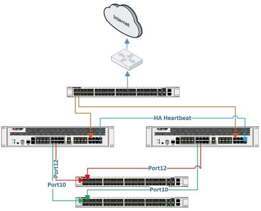

The example network diagram is provided below. Port10 and Port12 are part of the redundant link.
For the session load balance to work in this Active-Active cluster displayed in the diagram, port10 should be connected and UP on the Secondary FortiGate unit. If Port10 on the slave unit is not connected or the status is 'DOWN', the HA Primary cannot load balance sessions to the secondary.
This does not apply to connectivity on the Primary unit, sessions are load balanced to the secondary unit with any single member of the redundant being connected and UP.
