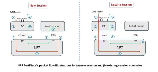

The Network Processor Units (NPUs) in FortiGates assist with hardware acceleration of traffic when a session is offloaded from the CPU to the NPU upon session creation. There have been several generations of NPUs, and the current FortiGate models utilize NP7, NP7Lite, NP6, NP6XLite, and NP6Lite. The F & G series FortiGates have the NP7 network processors, for example the 400F, 401F, 600F, 601F, 2600F, 2601F, 900G, 901G, etc: FortiGate NP7 architectures. To troubleshoot packet loss issues, an understanding of the packet flow through various components of the NP7 FortiGate platform would be needed, based on which corresponding diagnostic commands to trace the issue can be run. This article discusses the NP7 packet flow, as well as the various drop types available via diagnostic commands for the components and their interactions in the platform.
NP7 Packet Flow:
Before starting with troubleshooting any packet loss issues, it is important to understand the packet flow through the system (& the network) to trace the flow through the various components of a FortiGate, with corresponding diagnostic commands, and then narrow down the possible reasons for the drops (if any). A packet flow on the NP7 platform varies depending on whether the packet entering a physical port is part of an existing session or is part of a new session. Packet flows for these two scenarios are discussed below at a high level, between various components of a 4201F platform as an example, but should be similar for other NP7 platforms as well.
The reference architecture used for the above packet flow illustrations is here: FortiGate 4201F architecture.
Here is a typical packet flow on an NP7 platform, along with the diagnostic commands that can be used to trace the path and drops (if any), as the packet is traversing the various modules and sub-modules in the platform. Note that the exact packet flow would further depend on the traffic type and configurations on the device, and might differ from the steps illustrated below - but the explanation should generally apply for the most common scenarios.
Step 1. A packet enters the ISF module (Integrated Switch Fabric) through one of the physical ports of the FortiGate. The ISF does basic packet buffering and flow control. Port statistics can be retrieved using below CLI commands. Review especially the 'rx' counters, which correspond to packets ingressing the ISF module of the FortiGate. Look for any trend in switch error counters (CRC, over, under, collision, etc), htx drops & queue drops.
FortiGate# diagnose hardware deviceinfo nic port1
FortiGate# fnsysctl ifconfig port1
FortiGate# fnsysctl cat /proc/net/bcm/stats
Step 2. ISF then distributes the packets to NP7 modules using a 5-tuple hash over the CGMAC interfaces, as illustrated in the diagram. In a 4201F FortiGate platform, ISF connects to the NP7 modules over 2x 100G interface modules referred to as CGMAC (0 & 1). Review the 'rx' packet counters and drop counters over these CGMAC interfaces with the CLI commands below, which correspond to the packets entering the NP7 modules.
FortiGate# diagnose npu np7 cgmac-stats 0 v
Step 3. Packet next enters the EIF pipelines (Ethernet Interface pipelines) of NP7, from where they are distributed to the other sub-components of the corresponding NP7 module for processing. Use the below CLI commands to check for drops in EIF pipelines.
FortiGate# diagnose npu np7 dce-eif-drop 0 v
Step 4. The packet is now processed in the various sub-modules of NP7, depending on the packet's protocols and attributes. If this is a new packet that does not match any existing sessions in the session table (i.e, a session miss in the SSE), then this requires processing by the FortiOS kernel first to validate if a new session should be established for this packet or drop it for any policy match failures. On the other hand, if this packet is part of an existing session (i.e, a session match in the SSE), then the packet is processed by the NP7 itself depending on the features associated with that session. For example, if it's a VPN packet, then the IPSec engine is involved. If traffic shaping is required, the TPE engine is involved, and so on. Use the generic NP7 DCE drop command at this step to check for any drop counters incrementing in any of the sub-modules of the NP7.
FortiGate# diagnose npu np7 dce-drop-all all
Note: If the packet is processed in the NP7 itself (and not forwarded to the kernel), then these packets can be viewed using the NPU sniffers discussed in the section below called "NPU packet sniffers" (use with caution, and always with a very specific filter).
Step 5. If the packet needs to be forwarded to the kernel for further data processing (i.e, a session miss), then it is sent to the FortiOS (kernel) through HIF interfaces (Host Interfaces). NP7 uses the HRX interface (Host Receive) to send a packet to the kernel, and the kernel, after processing, sends the packet back to NP7 over the HTX interface (Host Transfer). NP7 then directly forwards the packet (without further processing) to CGMAC, to be sent out of the destination port through ISF in the egress direction.
FortiGate# diagnose npu np7 dce-hif-drop 0 v
FortiGate# diagnose npu np7 hif-stats 0 v
Step 6. A Packet could be forwarded to the Kernel for multiple reasons, one common reason being a new session establishment for control plane traffic (like a new SYN packet received). The kernel would process the packet according to the configuration for a session creation - by doing policy lookups, routing lookups, session helper, etc. Use the diagnose debug flow commands to review the processing logic of the packet in the kernel, which would show the steps involved in processing, like policy lookup, routing lookup, RPF checks, VPN control plane packet processing, etc.
FortiGate# diagnose debug flow filter addr 192.168.20.10
FortiGate# diagnose debug flow show function-name enable
FortiGate# diagnose debug flow trace start 100
FortiGate# diagnose debug enable
FortiGate# diagnose debug disable
Regular packet sniffers can be configured here to review 'kernel processed traffic', using the CLI commands as shown in the example below.
FortiGate# diagnose sniffer packet any 'src host 192.168.10.1 and dst host 192.168.20.1 and tcp' 4
If the packet was instead processed by NP7 (and not the kernel) like a data plane packet after the session establishment and hardware accelerated (default setting), then an NPU sniffer should be configured to view these packets, which is discussed in the section below called 'NPU packet sniffers'.
Step 7. After the processing of the packet in the kernel, if it is not already dropped for any policy check reasons, it would be sent back to the NP7 over the HTX interface. Here are the CLI commands that can be used to review the HTX drop counters.
FortiGate# diagnose npu np7 dce-htx-drop 0 v
Step 8. NP7 next forwards the packet out in the egress direction over CGMAC to ISF. The "tx" counters of the below CLI command can be used to review the counters and any drops at this step.
Step 9. ISF does a final egress passthrough of the traffic as it is exiting the FortiGate - drops at this step of the packet flow are usually very unlikely. Review the counters in the CLI commands below to observe any trend, especially the 'reply' counters.
Step 10. In this final step, the packet leaves the FortiGate from one of the physical nic ports (depending on the routing decision that was made in one of the earlier steps) of the ISF module. Review the 'rx' counters in the CLI commands below to check for any drop counters incrementing.
With this understanding of the basic packet flow in an NP7 platform, the next topic of discussion would be the drop counters in each of the sub-modules of the NP7. Following is a list of NP7 diagnostic commands to analyze these drop counters for hardware offloaded traffic in NP7, along with an explanation of what each of these drop counters corresponds to.
