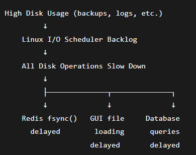

When the IOwait spikes, it will cause all the FortiAnalyzer functionalities to delay, such as GUI loading.
To fix the issue, ensure the logs respect the configured ADOM storage ratio (default 70%: 30%).
Then delete the old logs when they reach 90%.
