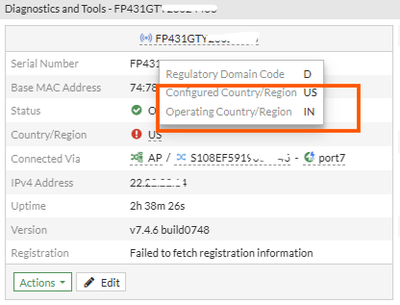

- Verify if the geographical region where the AP is deployed supports wifi 6E. See Wi-Fi.org's regulations for enabling 6 GHz Wi-Fi.
- Verify that the FortiAP is configured with the correct country code profile. See Troubleshooting Tip: The SSID is not broadcasting Issue on FortiAP/FortiGate setup.

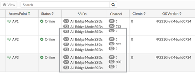

- When the FortiAP does not support 6GHz channels, the 'rcfg' output will show as follows.
Radio 2: AP country : cfg=HU oper=HU countryID : cfg=348 oper=348 802.11d enable : enabled sta info : 0/0 radio type : 11AX_6G mimo,chainmask : 2, 0x3 (mimo) 0x3 (power) 0x3/0x3 (oper) airtime fairness : disabled ps optimize : 0 tx optimize : f 11g prot mode : 0 HT20/40 coext : 1 beacon intv : 100 txpwr mode : set by percentage (100%) txpwr cfg/oper/max : 50/50/50 (EIRP +9) VHT param : gi=disabled bw=20MHz ack timeout : 25 r_ac MAX dista : 0 ackt_2G=64 ackt_5G=25 r_ac chan : num=0 age=64 channel : num=0 oper_chan : 0 r_ac md_cap : r_ac chan list : chan list : hw_chan list : <---- (The hardware channel list is missing: this means the hardware did not report available channels to the OS.)
nol list : chutil meas : enabled sensor mode : disabled (applied promisc mode=disabled) ap scan : background regular scan, ap scan thresh : 0 dBm
- An empty HW channel list could mean any of the following:
- A regulatory restriction Is Blocking Radio 3.
- The country code does not allow 6 GHz (Wi-Fi 6E).
- The country has not fully adopted 6 GHz (Wi-Fi 6E) for indoor/outdoor Wi-Fi use.
