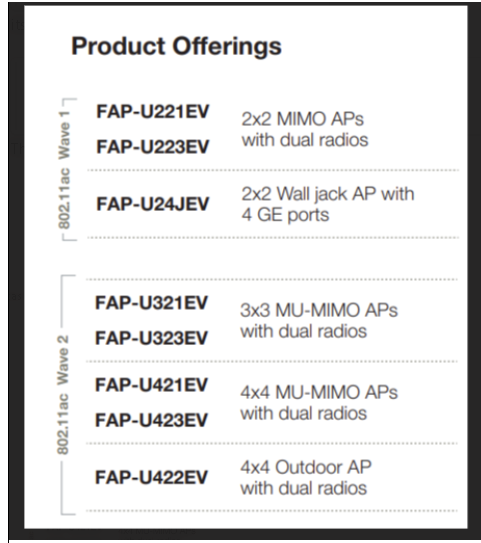

The following are Product Offerings for FortiAP-U:
The Firmware Upgrade path to follow for these models is as follows: v6.0-build0028 -> v6.0-build0080 -> v6.2-build0220 -> v6.2.1-build0237 -> Then to Special Build v6.2.2-build4001 -> v6.2.2-build0267 -> v7.xx.
