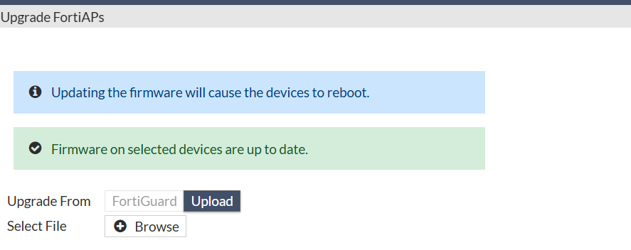

Description This article desrcibes a known behavior when attempting to update managed FortiAP-W2 units from the FortiGate using FortiGuard (WiFi & Switch Controller -> Managed FortiAPs).
FortiGate, FortiAP-W2, which includes: FortiAP-221E, 222E, 223E, 224E, 231E,  FortiAP-321E, FortiAP-421E, 423E.
As of February 2024, firmware images for the FortiAP-W2 models are no longer available for download from FortiGuard servers. Note that this is different from the Fortinet Support site, where firmware files for these FortiAPs can be manually downloaded as .out files.
In a practical sense, this means that it will no longer be possible to upgrade managed FortiAP-W2 units from the FortiGate using FortiGuard. Instead, it will only be possible to update FortiAPs via File Upload (which is only possible if the FortiAP has an active Support Contract):
