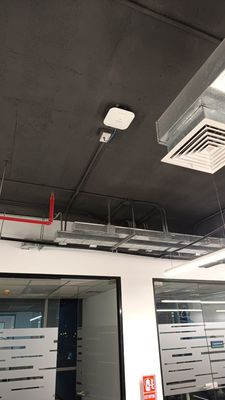

Do not place the FortiAP behind any metal object, such as pipes, rails, or behind a ceiling:
