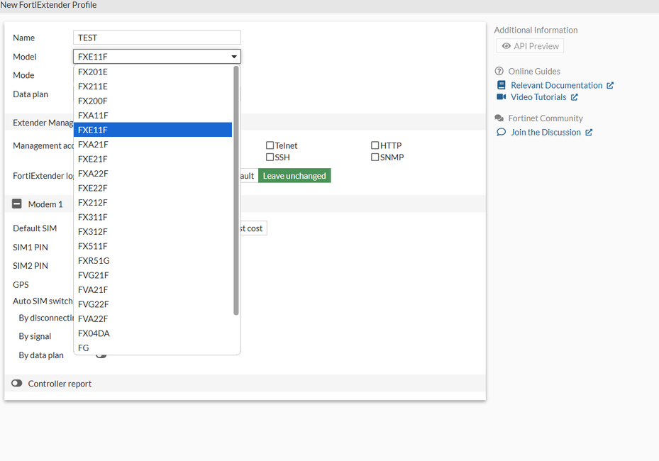

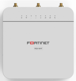

The hardware model name displayed on the physical FortiExtender is 101F, as shown in the attached image.
This model name is consistent with the compatibility information listed in the FEXT_HW_and_Modem_FW_Compatibility_Matrix and Firmware download Portal: https://fortinetweb.s3.amazonaws.com/docs.fortinet.com/v2/attachments/64b6e80f-9de9-11ee-a142-fa163e...

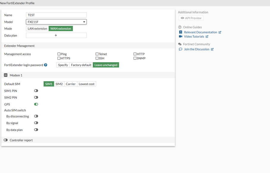

In these instances, it is necessary to select FortiExtender-11F/FortiExtender-11F based on the device's serial number.
