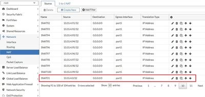

  1. In the example, the FortiADC is configured with a network NAT-SNAT policy up to 100 rules. A rule 'SNAT01' is located at the bottom of the rule list.

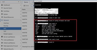

  1. Open the FortiADC CLI console panel or log in to the FortiADC SSH shell access. Use the example of the commands below to re-order the 'SNAT01' rule to be on top of 'SNAT02'.
config firewall nat-snat
move SNAT01 before SNAT02

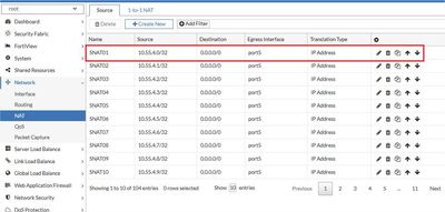

  1. Refresh the FortiADC Source NAT page, and the SNAT rule 'SNAT01' should be on top of the 'SNAT02' rule now.

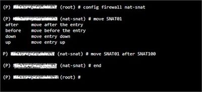

  1. To move or re-order the SNAT policy rule to the bottom, use the example commands below. The SNAT policy rule 'SNAT01' will be moved to the sequence after 'SNAT100'.
move SNAT01 after SNAT100
