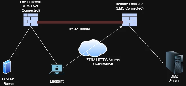

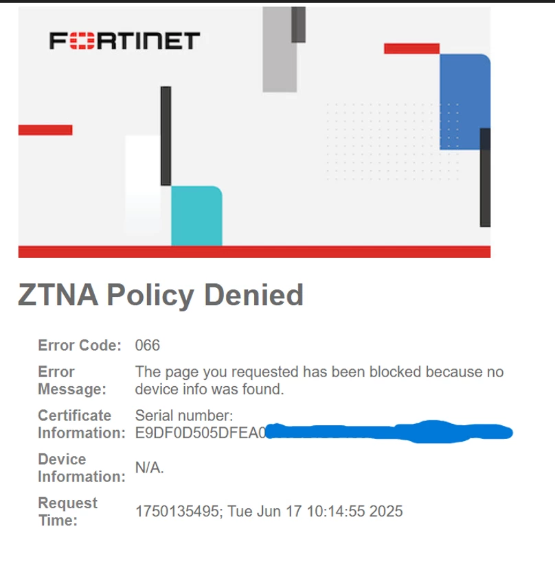

I'm currently using FortiClient EMS 7.4 and FortiGate running FortiOS 7.4. When I try to access a server located in the DMZ using ZTNA access policies with ZTNA tags, I receive the following error:

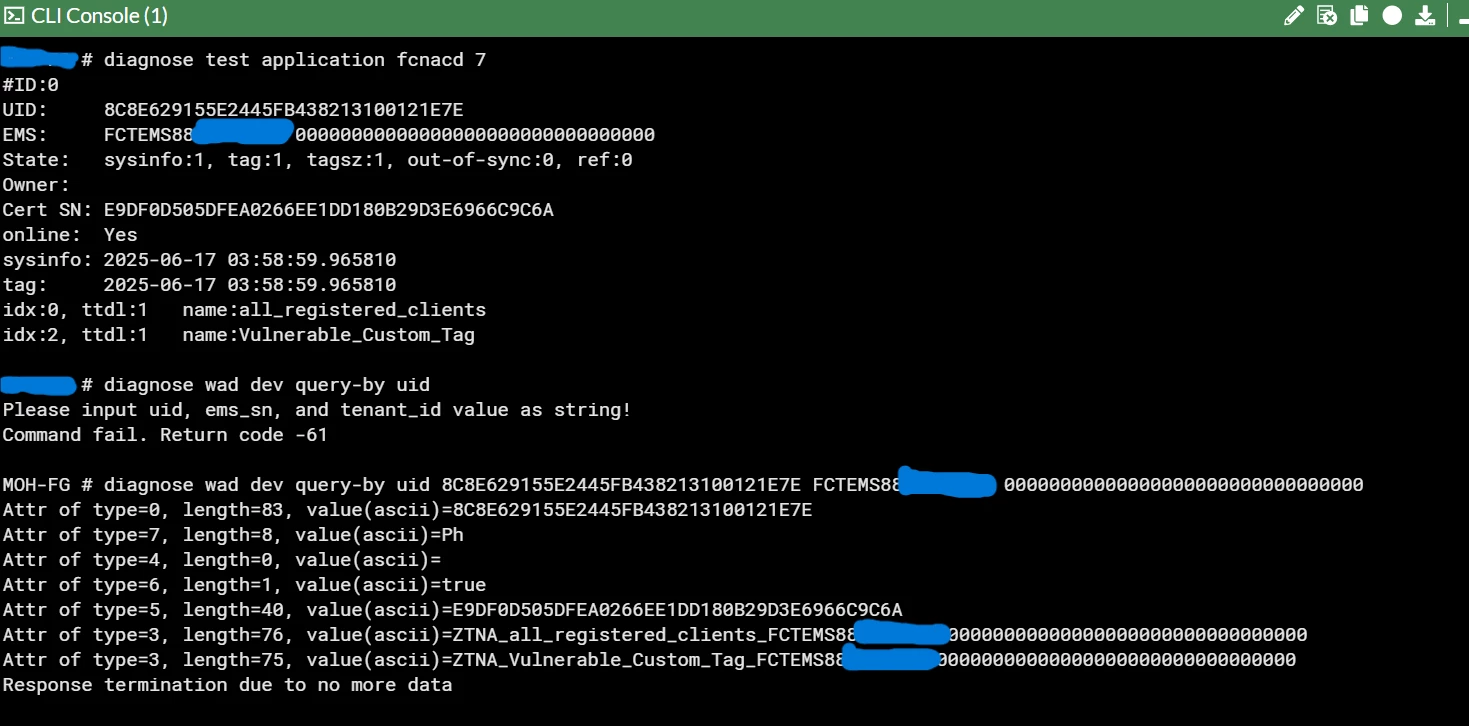

Despite this, everything seems fine on the FortiGate side:
  1. The ZTNA tags are successfully synced from EMS.
  2. The relevant endpoint appears under the correct tag in the FortiGate.
  3. Running diagnostics shows that the endpoint is recognized and tagged appropriately.
  4. "diagnose endpoint ec-shm list" command correctly shows the endpoint info.

Error 066 (“No device information found”) indicates the FortiGate did not receive the endpoint-identity header from FortiClient, so it cannot match the HTTPS request to a device record and therefore denies the ZTNA policy. The FortiClient agent is not injecting the header—most often because the ZTNA connection rule (FQDN/port) does not match the URL the user is accessing, the ZTNA certificate pairing is broken, or the client is not in a “ZTNA Connected” state.
https://docs.fortinet.com/document/fortigate/7.6.0/ztna-reference-guide/25473/error-codes-and-replacement-messages
The following debug commands can be used to further more analysis:
  • diagnose endpoint record list <client-IP>
To see if the device record or tag updates arrive run real-time fcnacd debugs:
  • diagnose debug application fcnacd -1
  • diagnose debug enable
Troubleshoot WAD in real time to see how the proxy handles client requests:
  • diagnose wad debug enable category all
  • diagnose wad debug enable level verbose
Once we have the captured output, we can trace exactly how wad handled each request and pinpoint the root cause.
