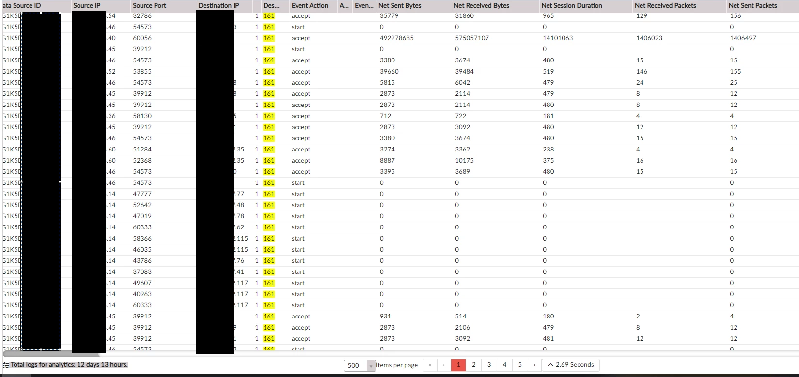

So using fgm logs and faz they both show me the same results. for some tcp session we can see number of packets sent and received is 0, along with data transferred 0, this makes sense, tcp handshake probably doesn't complete (or does complete then reject) and no further transactions happens, therefore we have a session with zero bytes transferred. All good.
But for UDP, the packet is just transmitted, now regardless of whether it makes it to the receiver or not,  how can it possibly be 0 bytes sent and received and 0 packets sent and received? I see this on both fmg and faz for some traffic.

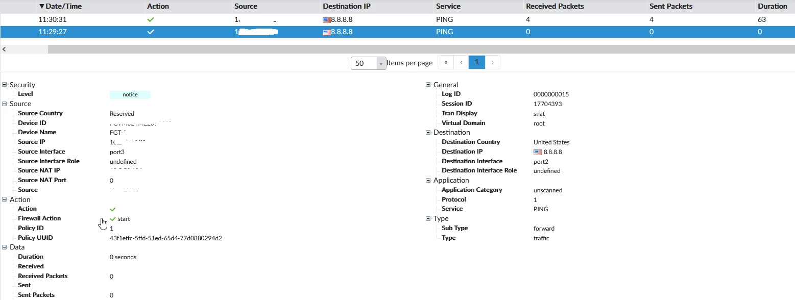

flamer
flamerAuthor
March 22, 2023
Hello yes the traffic is being accepted by policy.
Screenshot taken -
srajeswaran
March 22, 2023
When you enable "set logtraffic-start enable" under policy config, the system generates a log as soon as the session is created and this log don't have any data/packets details. These logs shows packets "0", there will be another log generated when the session is closed or after 2 minutes if the session is active for more than 2 minutes with the current packet details/counts.
In below image, both entries are for same session, first one generated at the beginning with "0" packets and the second one generated after the session is closed with the data/packet count.
