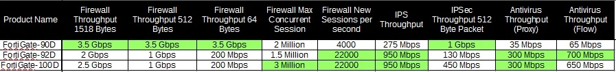

I have added the 92D in the comparison mix; between these 3 models, hands down the 90D can't be beat in shear firewall and IPSec throughput.  However, the 90D is lacking in firewall new sessions per second and anti-virus scanning. Both the 92D and 100D outperforms the 90D in IPS/anti-virus scanning throughput.
I can't see myself deploying a Fortigate without providing or setting up some sort of IPS/anti-virus protection to the client -- in this regard I'd likely choose the 92D or 100D over the 90D.  And if price and annual subscription fee were an issue,  I may choose the 92D (depending on how close in price between the two).
That said, real life numbers are more important than theoretical max values -- with 30-40 users on a 100 Mbit connection, I'm sure all 3 models will perform equally in most areas, especially with proper coding/optimizing on the Fortigate config.
My bottom line; while the 90D looks attractive on paper for raw firewall/IPSec throughput, I would scope out just how much daily IPsec tunnel traffic is expected to go through the Fortigate.   Unless there are mission-critical apps, there may be little to no difference, load-wise, on the IPsec tunnel connection (on any of the models).

Yes, I know all this. That is why I am still puzzled why some still say I should go with the 100D. Is that just old reputation?
For the above specified needs, isn´t the 90D be better? I know 100D is meant for bigger offices than all the smaller models, but in this case, the 100D seams like a slow big brother when it comes to plain throughput and IPsec!?

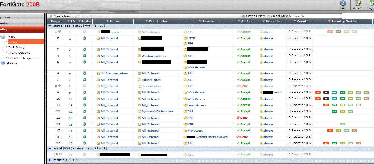

Sounds like you already made up your mind, so run with it -- contact your local Fortinet dealer and ask to borrow a demo 90D to play around with.
Regarding coding/optimizing, it's more of a throwback to the old 4.1/4.2 firmware days where you really needed to craft/tailor the UTM options to the traffic.  e.g if your company is an all-Apple Mac shop there may be no real need to craft IPS/anti-virus sensors to Windows-based PCs -- you don't want the Fortigate spending any more time then needed scanning for something that's not there.   This includes setting up the proxy options/SSL/SSH inspection options and creating separate fw policies (http/https, pop3, ntp, dns, other, etc.)  The attached pic shows an example config (original was created for us by another company which I just expanded upon).  It's an "open" firewall rule set.  (Our in-house Fortigate is configured differently as a  "closed" rule set.)
