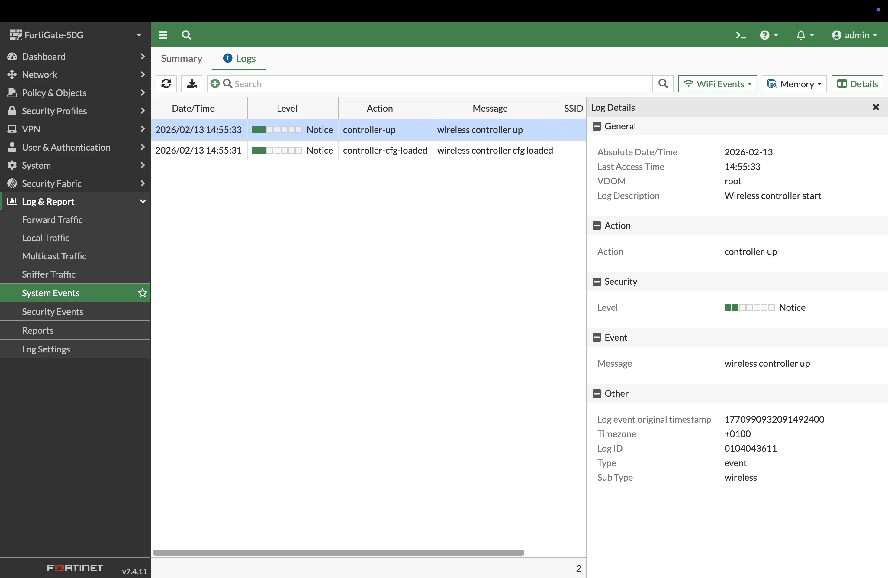

Hello to everybody,
Two days ago, the following system events appeared:
I haven't activated this and I do not know how this could happen. My FortiGate does not support WiFi (or this is what I thought...). Please, what do I have to do to turn off the Wireless Controller? Thank you for your help.
Best answer by ede_pfau
What @funkylicious is hinting at (but I cannot follow ATM because the doc site lags...) are these global commands:
config system global    set wireless-controller disable    set switch-controller disable    set fortiextender disable end
This would disable the functions in FortiOS to control external peripherals, that is, WiFi, switches and FortiExtenders.
Why you would want this is a bit obscure to me - enabling the management will not bring the necessary hardware into existance, so the FGT would not start to transmit WiFi then. Also I don't really see any way to exploit it from within your local LAN. True, some ports would be open and listened to, like 5246 or 25246.
By default, only the WiFi controller is enabled.

February 17, 2026
Thank you. I have ran wireless-controller disable. It worked. I understand your point of view but when I saw this on the events, I get afraid. Now I feel safer.
