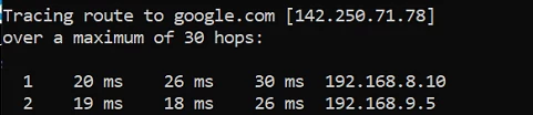

It was noticed that devices connected to Wi-Fi send traffic over WLAN controller and not directly via default gateway.
Is it normal for FortiNet wireless controller to act as a router?
If yes could you please help to set up a static route.

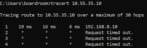

There is an IPSec VPN tunnel between the office and the environment in Azure and devices conencted to wi-fi can't communicate with Azure infrastructure as the wireless controller seems doesn't know where to forward traffic.
I can confirm that for the wireless network 192.168.9.0 the default gateway IP is 192.168.9.5.
I also tried to add static route manually route -p add 10.55.35.0 mask 255.255.255.0 192.168.9.5 but that didn't help either.

Hi @MadDog_2023,
Traffic should go to the default gateway unless you have a specific route to 10.55.35.0/24. Please check your routing-table by running "route print". You also need to create rules to allow traffic on the WLC.

Hi @hbac
As I mentioned I added route manually route -p add 10.55.35.0 mask 255.255.255.0 192.168.9.5 on a desktop but traffic still goes through wireless controller.
192.168.9.5 is a default gateway.
192.168.9.XXX is the IP address of the desktop.
Where do I do that?
P.S. On the FortiGate router there is a route that send traffic to 10.55.35.0/24 over VPN to Azure. It is just for some unknown reason the wireless controller send traffic through itself which I've never seen before. If it is how FortiNet Wireless Controller works then there should be an option to add a route.
