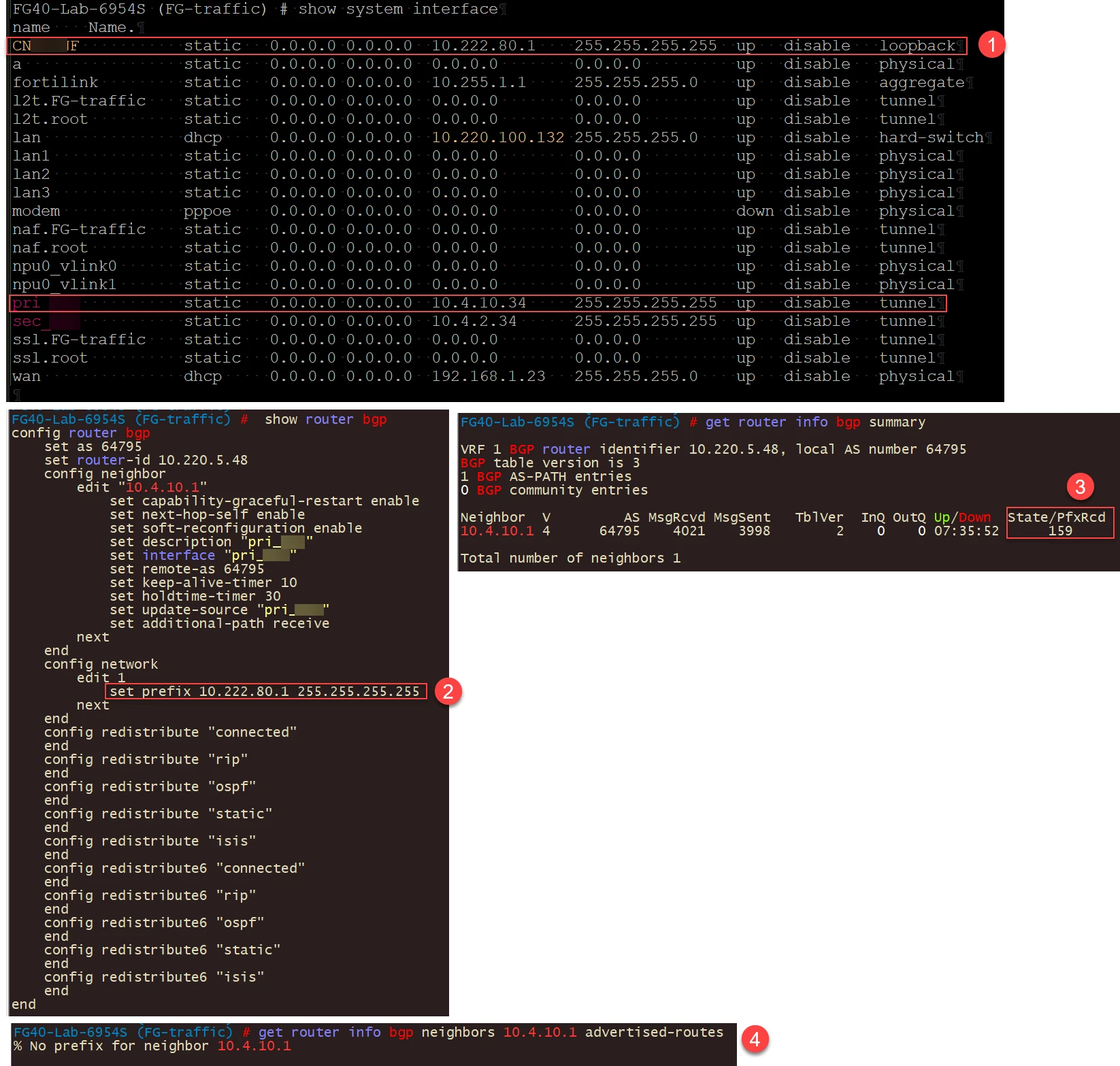

I have a loopback 10.222.80.1 configured (1)
I have advertised the same prefix in BGP. (2)
The BGP neighbor 10.4.10.1 in question is healthy with 159 routes received (3)
Why is this prefix not advertised via BGP? (4) 

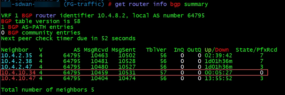

10.4.10.34 and 10.4.10.31 can ping each other. They are the 2 ends of the healthy BGP peer.
Below is the BGP summary from the other (hub) side.
I changed the router ID from 10.220.5.48 to the loopback 10.222.80.1 no change in outcome though.
Appreciate the suggestion though.... please share if any more ideas come!

srajeswaran
December 17, 2023
Do you see the loopback address under bgp networks on FG40-Lab-6954S ? Can you run "get router info bgp network" and confirm?

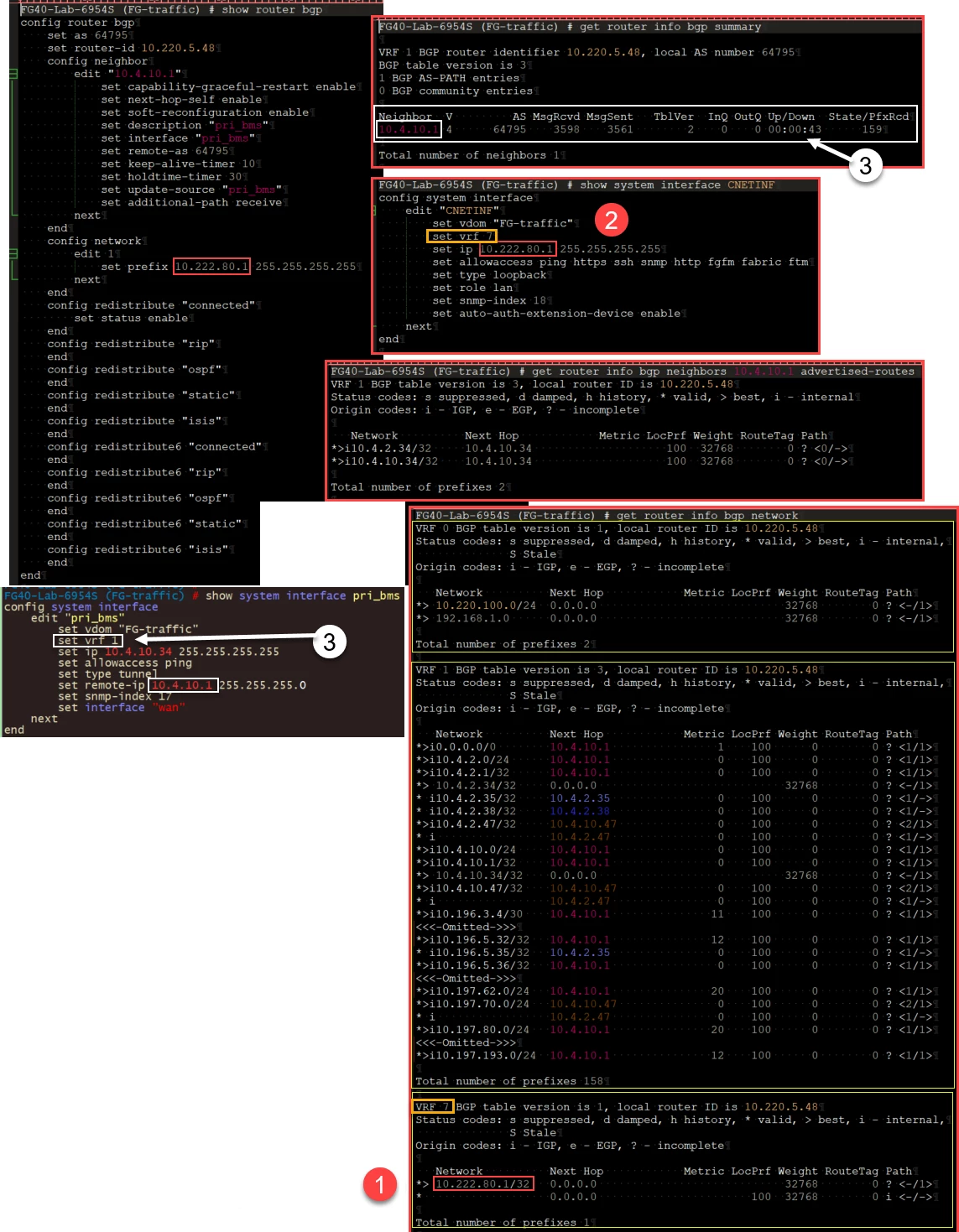

slouw
slouwAuthor
Explorer III
December 18, 2023
@srajeswaran good question thank you. I was wondering/looking into a VRF angle on this matter. The loopback is in vrf=7 (Ref 2 in screenshot) and does in fact appear in the bgp database (is that the right term? BGP database or BGP routing table?) Ref 1 in screenshot
The overlay interface over which BGP is running is in fact in VRF 1 (Ref 3) Might this matter?
What if I build another overlay in vrf 7 (same as loopback)?
