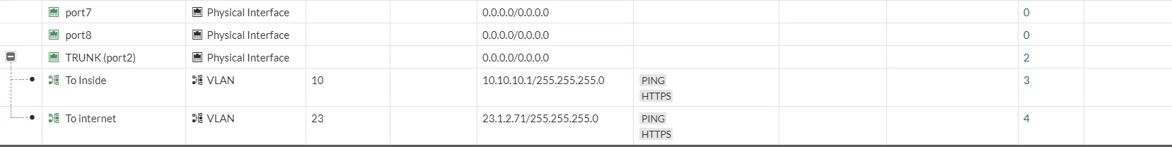

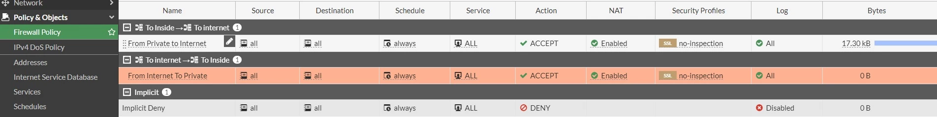

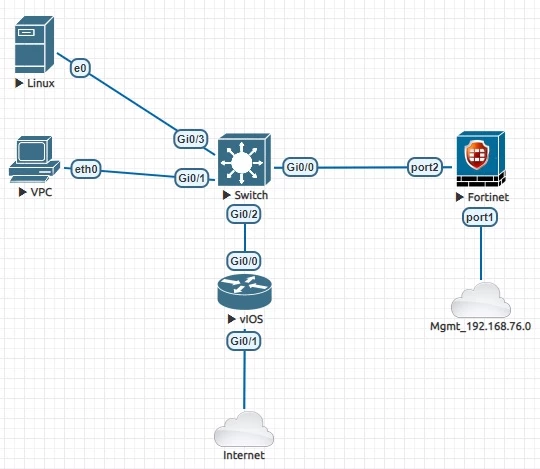

Hi,
I don't understand why I cannot ping internet from Clients. I can ping subinterface on port 2 23.1.2.71. But if I try ping  from Linux or VPC 8.8.8.8 it is unsuccessful. I have static route on FortiGate 0.0.0.0/0 to router 23.1.2.1 which is router IP on port gi0/0. Switch ports gi0/0 and gi0/2 are trunk and ports gi0/1 and gi0/3 are vlan interfaces. I can ping internet 8.8.8.8 from Fortigate. Something on FW is missing I guess. Policies are applied and when I ping from client to subinterface "To Internet", policy is working. Please check pictures.

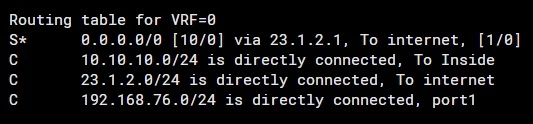

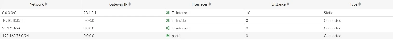

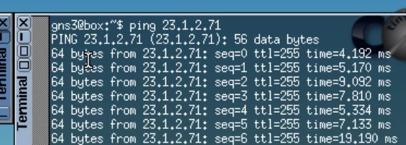

Yes, if I ping from linux to DG 23.1.2.71, the ping is successful and it hits the policy. However ping doesnt want to go furthet to router 23.1.2.1 and to internet and I dont know why. Routing table is as on a picture. I have tried to type that commands into CLI, but it didn't do anything. I am a beginner so please bear with me

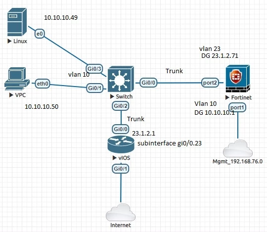

Do you mind to put the ip address on the diagram too so I can understand better on your deployment? The gateway is on the switch or Fortinet?

Matie
MatieAuthor
August 24, 2022
Gateways are on a FortiGate. Here is topology picture
Debbie_FTNT
August 24, 2022
Dear Matie,
your setup looks ok as far as I can see - you have a policy in place from private to internet with the appropriate interfaces, and you have routing in place. The policy also applies NAT, so this is not a case of private IPs going out and getting dropped.
Can you run a traceroute command from the host in question to 8.8.8.8 to verify at which point the traffic is failing?
This could be a case of the ping going through FortiGate, but the reply not making it back for whatever reason.
I would assume that to be unlikely, given that pinging from FortiGate itself works, but it wouldn't hurt to double-check that the ping reaches FortiGate and then gets lost.
