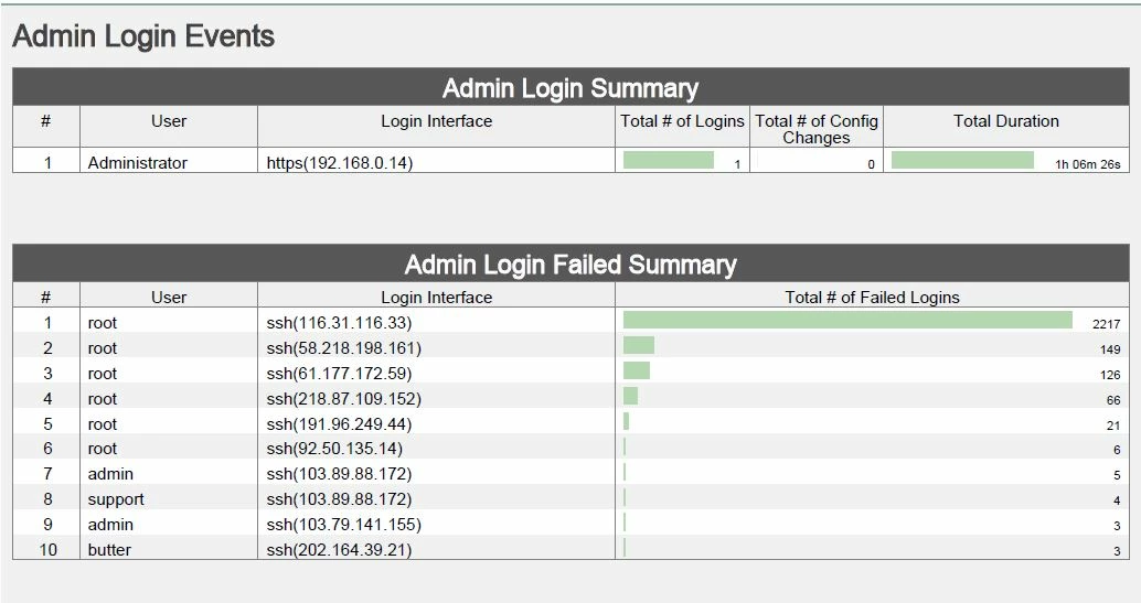

We have a lot of Attacks report against our FORTIGATE 90D.
What's correct to do in that case? turning off service SSH? create rules to block a list of suspect IPs?
Thank in advance for any sugest or information, I attached a example of report

    emnoc
    July 6, 2017
    1: don't use port 22
    2:  enable two-factor
    3:  use SSLVPN  and then allowaccess ssh  for ssl.root this will force the admin to  come in via ssl and then you trust that ssl.pool address over the ssl.root interface
    4: use  trusthost
    http://socpuppet.blogspot.com/2014/12/hardening-your-unix-ssh-server-access.html
    http://socpuppet.blogspot.com/2015/03/sslvpn-sslroot-management-access.html
    As long as you have tcp.port 22 open and no trusthost, you will ALWAYS have failed logins for the common  accounts

    Zac67
    September 1, 2017
    If you don't really require SSH on WAN just deactivate it. If you do need it you should at least restrict login to those subnets you need to allow access.
    emnoc
    September 1, 2017
    1> I would never run  tcp.port 22 for SSH on a public-internet
    2> if you look at the screenshot  these same useracounts are always going to show up ( root admin Admin administrator support etc....
    3> deploying ssh access over tcp.port 2022 for example, would reduce or eliminate this issue
    4> deploying a SSH portal access ( they have to login via SSLvpn ) and then allowaccess over the ssl.root interface is even more better imho
