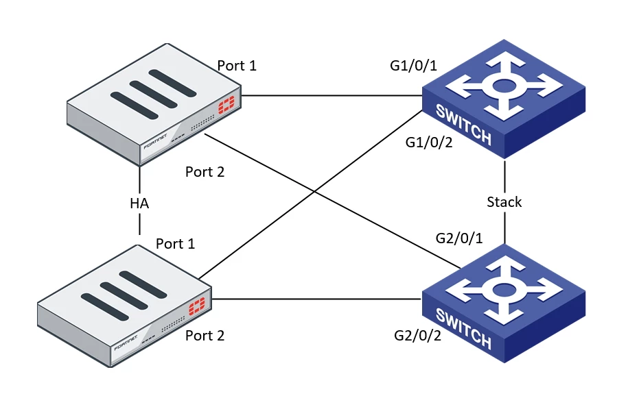

Hi All,
As show below picture
Fortigate 1 port 1 connects to Cisco switch G1/0/1
Fortigate 1 port 2 connects to Cisco switch G2/0/1
Fortigate 2 port 1 connects to Cisco switch G1/0/2
Fortigate 2 port 2 connects to Cisco switch G2/0/2
My questions are
1) My fortigates work on Active-Active mode, port 1 and port 2 are set as  1 802.3ad aggragate port. What should I configure my switch ports? All the four ports in one channel group? Or G1/0/1 and G2/0/1 in one channel group, G1/0/2 and G2/0/2 in other channel group?
2)  If my fortigates work on Active-Passive mode, port 1 and port 2 are set as  1 802.3ad aggragate port. What should I configure my switch ports? All the four ports in one channel group? Or G1/0/1 and G2/0/1 in one channel group, G1/0/2 and G2/0/2 in other channel group?
Thanks in advance!  Best regards
Best answer by Markus
Hi Maybe this can help https://help.fortinet.com/fos50hlp/54/Content/FortiOS/fortigate-high-availability-52/HA_full_meshExample.htm We have coupleof FG in Production, but for now, we've never used Full-Mesh. We do 802.3ad aggragate too, but we don't use A-A, only A-P FG1 --> SW1 FG2 --> SW2 Best regards

February 25, 2019
