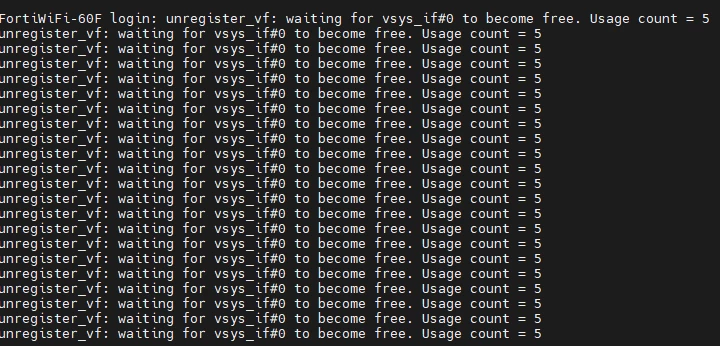

I have a FortiWiFi 60F new out of the box. I upgraded it from 6.4.6 to 7.0.11 following the upgrade path. I have console window up and it constantly displays  unregister_vf: waiting for vsys_if#0 to become free. Usage count = 5.
I google and looked here in the forums and can find nothing about it. I see references to HA, but this gate's HA is in standalone, so HA is disabled. What is this?

Best answer by UnderscoresAndDashes
ok, never mind. I booted to the secondary Partition, upgraded from 6.4.11 to 7.0.11 and it's gone. Guess something weird happened during the firmware upgrade on the other partition.
Thank you.

Do you have any debugs enabled?

No, I even double checked.
Thank you.
