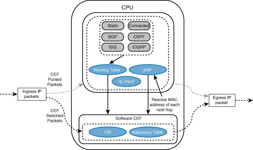

Toshi_Esumi
May 31, 2024
To supplement (or visualize) @ozkanaltas explained, I'll post Cisco's Express CEF architecture diagram here since FTNT doesn't have a good diagram published. Just replace the bottom half of this diagram as FGT's NPU and its memory. Both Cisco and Juniper has the same, or similar architecture separating RIB for CPU and FIB for forwarding hardware. And most of decent highend vendor products like FTNT are doing the same. You can use these terminology to search more detail about the technology online.
Toshi
