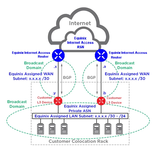

Hello,
We've got a BGP configuration in the datacenter (see screenshot below) and we have 2 FortiGates (100F).
We want to make the FortiGates highly available. But for both ports we have a /30 subnet so our external IP address is different for both ports.
Is this even possible (to have different IP addresses on both ports and use HA) or should we switch to a different configuration

Hi @JesperAP ,
I am not a design expert. When you configure FGCP you have to configure the WAN interface IP on primary unit and it will be automatically sync'd to secondary unit, so primary and secondary units interfaces have the same IPs. On your WAN interface you may enable/assign a secondary IP (using the IP belonging to the secondary BGP subnet /30). Bear in mind that the BGP configuration/peering will only be active on the current primary unit and I am not sure about the performances of that implementation and consequent BGP peering failover.
https://docs.fortinet.com/document/fortigate/6.4.0/ports-and-protocols/564712/fgcp-fortigate-clustering-protocol
It might be worth contacting your SE and ask for a Professional Services consultancy.

Isn't it a option to make a VDOM exception for the WAN interface?
https://docs.fortinet.com/document/fortigate/7.0.5/administration-guide/105611/vdom-exceptions
How do I specify to only have a exception for the WAN interface?

You can not do HA with those two FGTs because this BGP design assumes two independent routers (FGTs) on the customer end.
