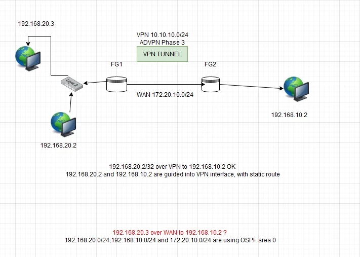

Hi
Is there a way, when i guide one of my host into VPN tunnel and it works great.
Is there a way, to ping it over a WAN interface also ?

FG2.jpgFG1.jpgThe hosts 192.168.20.3/32 and 192.168.10.2/32 can reach each other through OSPF if OSPF is configured properly (you mentioned that they are both in the same area 0).<---They are and when 192.168.10.2/32 static route are disabled, they can ping each other.
Right now i could not ping over WAN.
I have OSPF Area 0 (192.168.10.0/24 is advertised here) over WAN and OSPF Area 1 over VPN.
192.168.10.2/32 is staticaly advertised into VPN tunnel.
Monday i try to remove static routes and advertise 192.168.10.2/32 into OSPF Area 1.

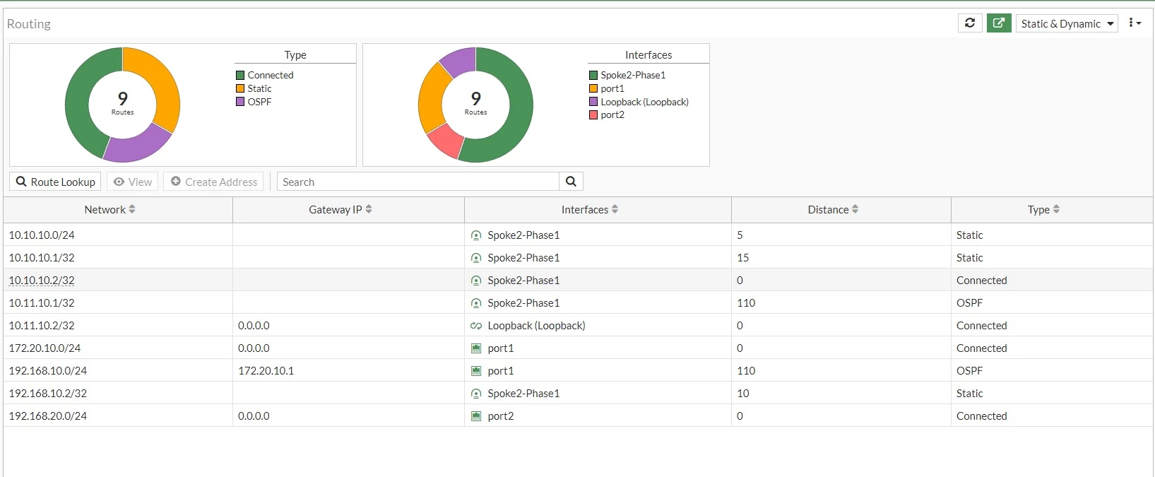

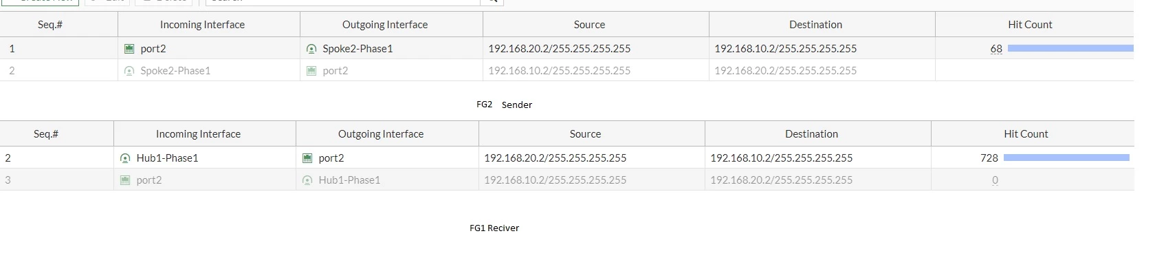

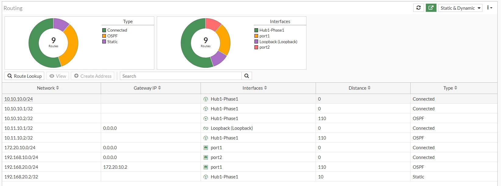

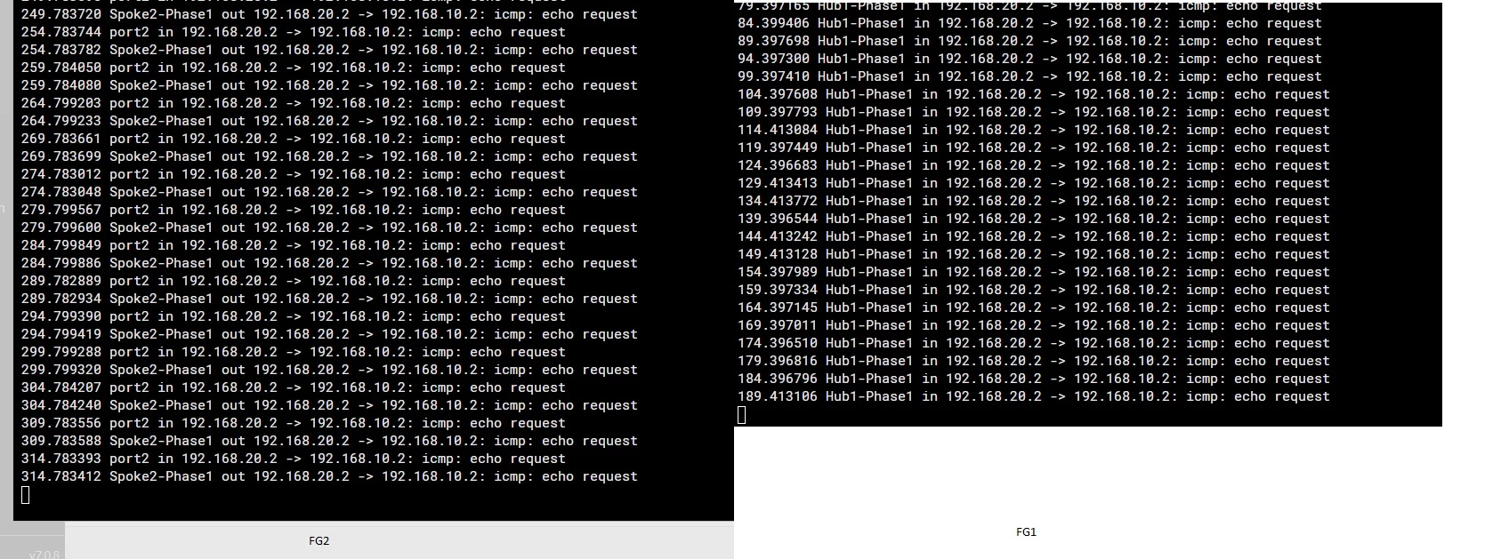

I tryed to implement Routing Policy.
So i changed routing a little.
Over WAN i'm using static routes. 192.168.20.3 and 2 can ping 192.168.10.2.
Over VPN i advertise OSPF and same ip subnets.
When i try to use Policy routing, pics included i can get a match, but i cannot get a full ping.
Do i have to too reverse Policys also ?
Tnx for all the help and answers :)
TestUser777
July 10, 2024
I got it to work.
At first i had static route to WAN and OSPF route to VPN.
Only Static route to WAN was in the routing table.
So static route to WAN and VPN did the trick.
Had two different routes to same network over WAN and VPN and Policy Routeing could to it thing
