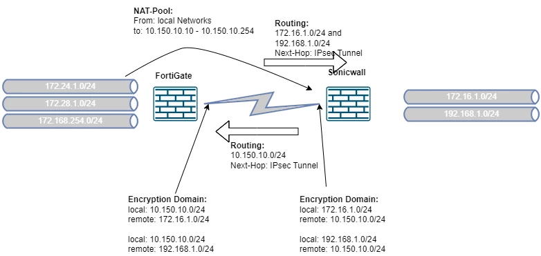

scan888
October 13, 2022
Hello
From my understanding that is your scenario.
Could you please check if you have the right routing entries and the phase2 settings are correct.
Next, we need the formatted output from the debug flow as @ESCHAN_FTNT has written.
