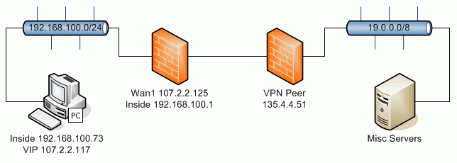

Had this setup with a PIX515 fairly easily, just can' t seem to get it to translate to my Fortigate 60C. Here is the VPN setup from our customer. (IPs have been randomized, sort of) Parameter - Customer - Us VPN Gateway - 135.4.4.51 - 107.2.2.125 Ecryption Domain - 19.0.0.0/8 - 107.2.2.117 Support key exchanged for subnets is - ON - ON Encryption - IKE:AES256:SHA - IKE:AES256:SHA IKE phase1 timeout - 1440 min - 1440 min IPSEC (phase 2) timeout - 3600 sec - 3600 sec DH group for P1 - 2 - 2 PFS - Disabled - Disabled Keepalive - Disabled Disabled I' ve tried both policy VPN and interface VPN setups, they just wont seem to connect. is what extra info can I post to help figure this mess out. I' m about to setup the PIX just to get this tunnel working again. config vpn ipsec phase1 edit " vpnCUSTpol" set interface " wan1" set nattraversal disable set dhgrp 2 set keylife 86400 set proposal aes256-sha1 set dpd disable set remote-gw 135.4.4.51 set psksecret ENC 7nV0BleK7zZepNi8NLPE6wMIGlpFOGIAbcYNTuiLyq+mTwhJvob8yjughpyZmcJcpILwAu8r5Hx8z0Xa3Jl6v8XVrhAiEX8qqvQLs4VolQkhJBiH set auto-negotiate disable next end config vpn ipsec phase2 edit " p2CUSTpol" set dst-addr-type name set pfs disable set phase1name " vpnCUSTpol" set proposal des-md5 set replay disable set src-addr-type ip set dst-name " VPN-Cust" set keylifeseconds 3600 set src-start-ip 107.2.2.117 next end

    emnoc
    February 21, 2012
    Are you 100% sure that your clients are being NAT' d behind the VIP address 107.2.2.117? Can you show us the associated fwpolicies?
    No, I' m not... And it should only be one client, the rest of the network is NAT' d out the WAN1 interface.

    What I really need to do is outlined in the first 3 posts here. But I seem to be unable to get the tunnel to come up in Interface mode. I assume this is because I cannot set the Destination Address in the Phase2 configuration, when in Interface mode. Which seems to be killing me since I' m trying to connect to a Cisco ASA.

    Whanson, To resolved your problem try with information below: Phase 2: Add command set use-natip disable In Firewall Policy: Add command set natip 107.2.2.117 255.255.255.255 Your configuration in Firewall Policy, that igual this: config firewall policy edit XX set srcintf " port1" set dstintf " wan1" set srcaddr " 192.168.100.73" set dstaddr " VPN-Cust" set action ipsec set schedule " always" set service " ANY" set logtraffic enable set logtraffic-app disable set natip 107.2.2.117 255.255.255.255 set inbound enable set outbound enable set natinbound enable set natoutbound enable set vpntunnel " vpnCUSTpol" next end

    That got it in Policy mode! Thank you!
