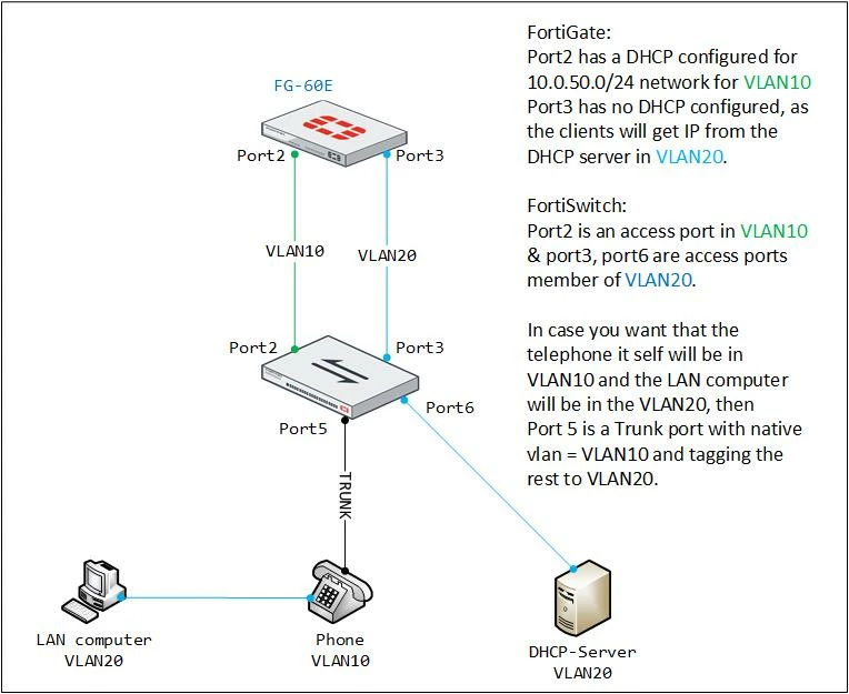

    Hi noitalever,
    I am not sure how the polycoms work, but you can achieve this topology as shown in the attached image. I assume that I understood your question. :D
    Hope it helps you further.
