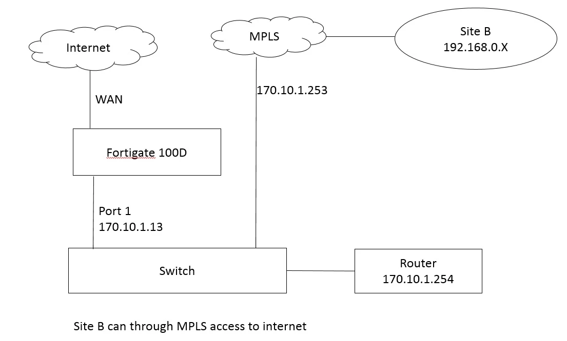

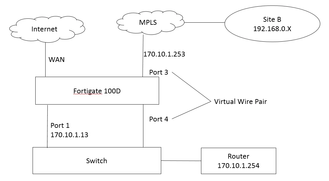

Site B is accessing internet through MPLS, the MPLS is directly to the switch without any control, I'm now would like to use a Forti 100D or 200E to do policy control, but after virtual wire pair set, it cannot access to internet.
the virtual wire pair is set to open all service and all source but still cannot go to 170.10.1.13.
I'm also try to use software switch, but after grouped port 3 and port 4, it cannot control by policy and just working like a switch.
Any wrong setting on the virtual wire pair?  please help...  Many thanks
Original Setting

Hi,
If the subnet 170.10.1.0/24 is on a vlan interface, you should consider allowing wildcard vlan on vwire.

October 17, 2022
it is not a vlan, no matter the VLAN wildcard is enable or disable which cannot connect. it likely cannot route back to the other port in the same device.

October 18, 2022
Please post the configs of vwire, firewall policy and port3 and port4 config. Also, did sniffer shows packets arriving on port3 for destination 170.10.1.13?
