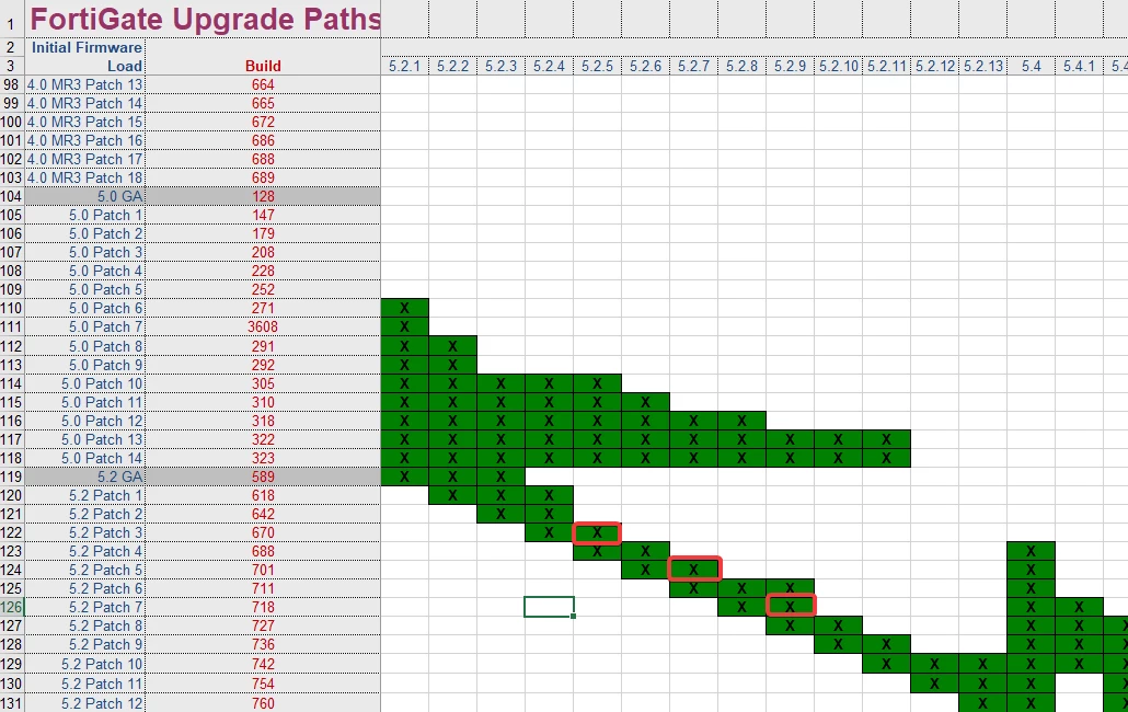

fjulianom
fjulianomAuthor
Explorer II
March 3, 2022
Hi abarad,
Thanks for your interest. For the document for upgrading legacy OS I understand I should upgrade from 5.2.3 to 5.2.5, (I think I can do this directly without go through 5.2.4). Then, once upgraded to 5.2.5 I upgrade to 5.2.7, and then to 5.2.9. Once upgraded to 5.2.9 I can follow the path according to the Upgrade Path Tool. Am I correct?
Regards,
Julián
abarad
March 3, 2022
Hi Julian,
Please note that if your firewall is in production it is recommended to follow upgrade path (in this case legacy os) .If firewall is not in production you can flash format Device and directly upgrade firewall to latest upgrade patch.
