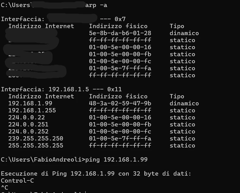

I tried connecting via Ehternet on LAN 1 but i get no address via DHCP (no IP was released and i have APIPA address) , i tried setting up manual with IP 192.168.1.110 mask 255.255.255.0 gateway 192.168.1.99 but i can’t ping, https or ssh to 192.168.1.99
If i look at the ARP table i see that 192.168.1.99 is present but i get no response in HTTPS , SSH and Ping

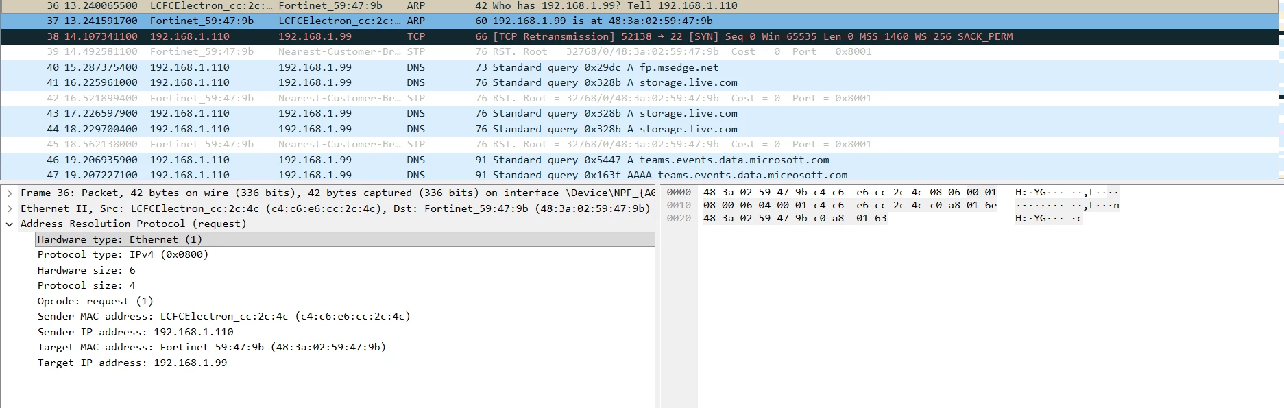

The weird thing is that using Wireshark i see that the Fortigate is responding to the ARP Requests but not to Layer3 traffic (HTTPS,DNS,SSH,Ping)

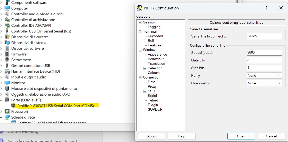

Then i tried using the console cable connected to the Console Port of the fortigate but also that didnt work:

May 18, 2026
