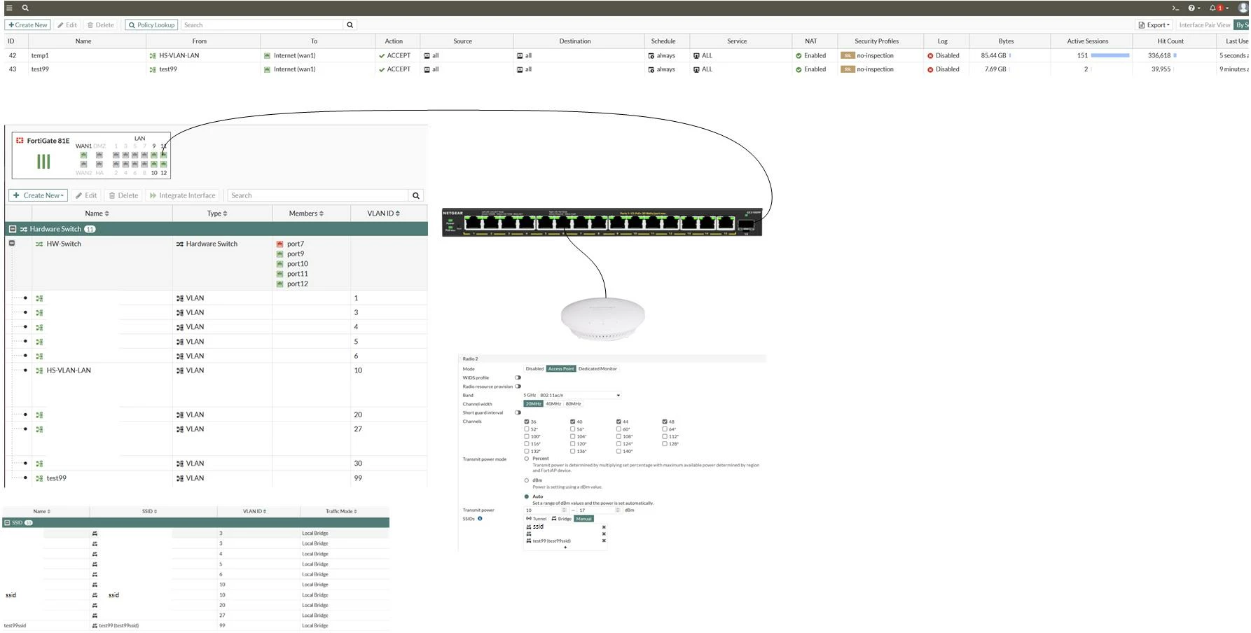

The network schematic:

I never had any of these issue, for over ~7 years. It started after upgrading to 7.0.11. And if you read the old topic, 2 things constantly cross: software switch vs hardware switch, that issue is now gone. All is connected to 1 hardware switch and VLANs with bridged ssids.
The netgear is configured to tag VLANs on the uplink and to the FAP. furthermore there are no (known) issues in the network other than this...

Yes all devices fail with roblox (2x phone, 2x tablet) on ssid. Not on test99.
Not sure what you mean with swap. Just change vlan numbers per ssid? So 10 to test99 an 99 to ssid?
gfleming
May 5, 2023
Yes exactly. If "ssid" is still broken on VLAN 99 then it's probably something related to the wifi. If it's working on VLAN 99 then it's probably something related to switching/wired stuff.
