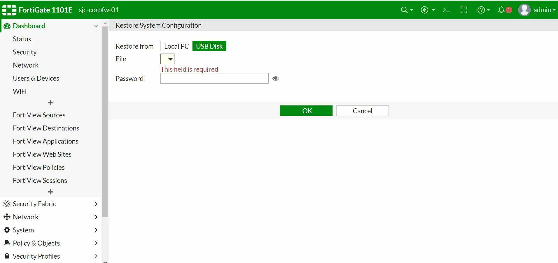

Toshi_Esumi
Apr 15, 2022 9:59 PM UTC
If you plugged in an USB memory containing a config file to your PC and you're at FGT's GUI to upload the file, it would be an upload from "Local PC" in GUI and you just need to point to the file on the USB memory.
The "USB DIsk" option in the GUI should be used when the USB memory is directly hooked up at the USB port on the FortiGate unit.
<edit>
Depending on the combination of your browser type/version and FortiOS version, you might see the password box is prefilled with something. I see it with Firefox 99.01 + FortiOS 6.4.8. In that case, you just need to empty out the box and hit OK to proceed. I don't see this problem with Google Chrome.
Toshi

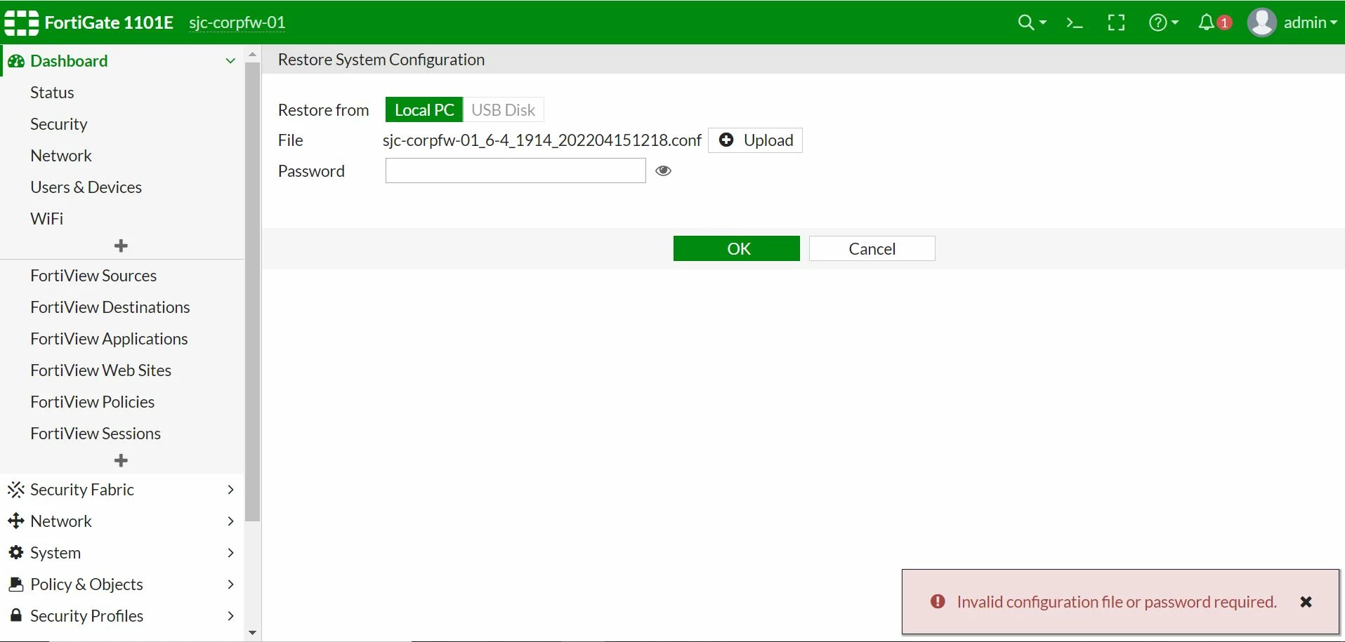

Thanks for responding to my inquiry.  I am still encountering issues with attempting to Restore the config files to our new Fortigate 101E Firewalls.
It seems that when I connect the USB stick directly to the hardware and attempt to view the config file from the GUI, the file is not visible. (Attached image to message).
Also, When attempting to upload the config file via the Local PC, I am getting an Invalid configuration file or password required.  There has not been a password set for the Restore Process.
Please advise.

Toshi_Esumi
Apr 16, 2022 8:37 PM UTC
Now I'm wondering if the backup config is for 1101E. Restore works only for the same model.

aahmadzada
Apr 17, 2022 7:13 AM UTC
Hello Jerry.
In a short, if you are restoring the config from a Fortigate 1101E to a Fortigate 1101E, that should work without any probem.
If you do upload the config of a Fortigate 501E to the Fortigate 1101E, that will not work, as these two Fortigates do have completely different hardware platform.
And in the case of Fortigates, the config file is hardware/model specific, meaning that you simply cannot restore the config file of one device to another.
The correct way of doing it is to utilize the Forticonverter tool, which will convert your current config file to be suitable to the Fortigate 1101E:
https://www.fortinet.com/products/next-generation-firewall/forticonverter
Or, you can migrate the config manually, as described here:
https://community.fortinet.com/t5/FortiGate/Technical-Tip-How-to-load-convert-a-FortiGate-configuration-file/ta-p/197247
Ahmad
