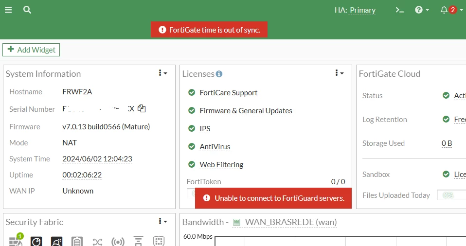

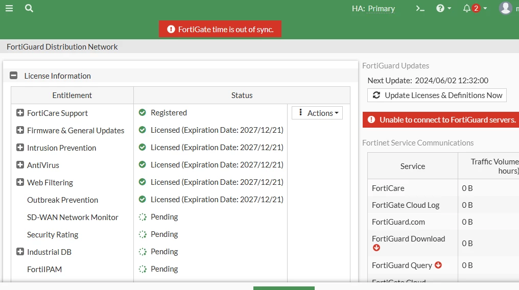

I am having problems connecting to the FortiGuard servers on a FortiGate 40f firmware v7.0.13 build0566 (Mature) (HA Cluster). I am also receiving the message "FortiGate time is out of sync.", I use an NTP server 200.160.0.8.
Images below
From FortiGate, I can ping the servers service.fortiguard.net, update.fortiguard.net, guard.fortinet.net. I get a response time of approximately 150ms. And I can also ping the IP 200.160.0.8 with approximately 18ms of response time.

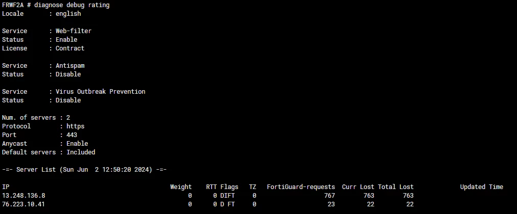

The output of the "diagnose debug rating" command is shown below:
I also tried changing from https to udp with port 8888 with the commands below and I was also unsuccessful.
config system fortiguard set fortiguard-anycast disable set protocol udp set port 8888 set sdns-server-ip 208.91.112.220 <-- IMPORTANT TO ADD THIS OR ANY OTHER FDN SERVER TO PREVENT DOWNTIME! end

I had to disable web filtering because without communication with the FortiGuard servers, all websites were being blocked.
