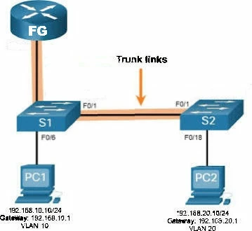

If i connect S1 “Fortiswitch” to S2 “Cisco ”   Using trunk port and in trunk port I allowed VLAN 20 only
on FortiGate  i create policy to route between VlAN 10 and VLAN 20
  1. Can PC1 in VLAN 10 ping to PC2 in VLAN 20 and if yes why and if no Why ?
      2. Is trunk port control traffic between different Vlan when i allowed VLAN 20 only in trunk or FortiGate will control traffic between different vlan ?

1 it should work; the FortiGate will strip the VLAN ID of the initiator and it will forward it attaching the new VLAN ID when doing the inter-vlan routing
2 if you have a PC in VLAN10 connected and configured on S2 and want to communicate to another PC in VLAN10 on S1 , due to the fact that only VLAN20 is permitted , traffic it will be dropped
