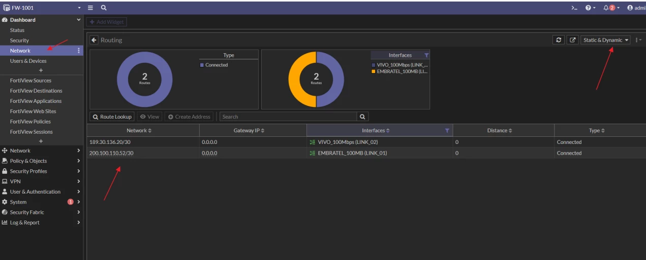

I am having a problem with a virtualized firewall in EVE-NG. One box does not bring up the static route 0.0.0.0/0 to the internet.
Below is an example of a box with an error. When it is in this state, I cannot communicate with the external IPs I have in the lab.

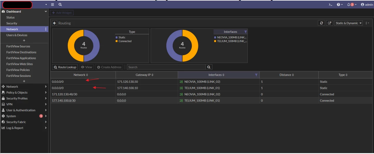

Here is an example of a box that has the 0.0.0.0/0 route to the internet and is functioning properly.

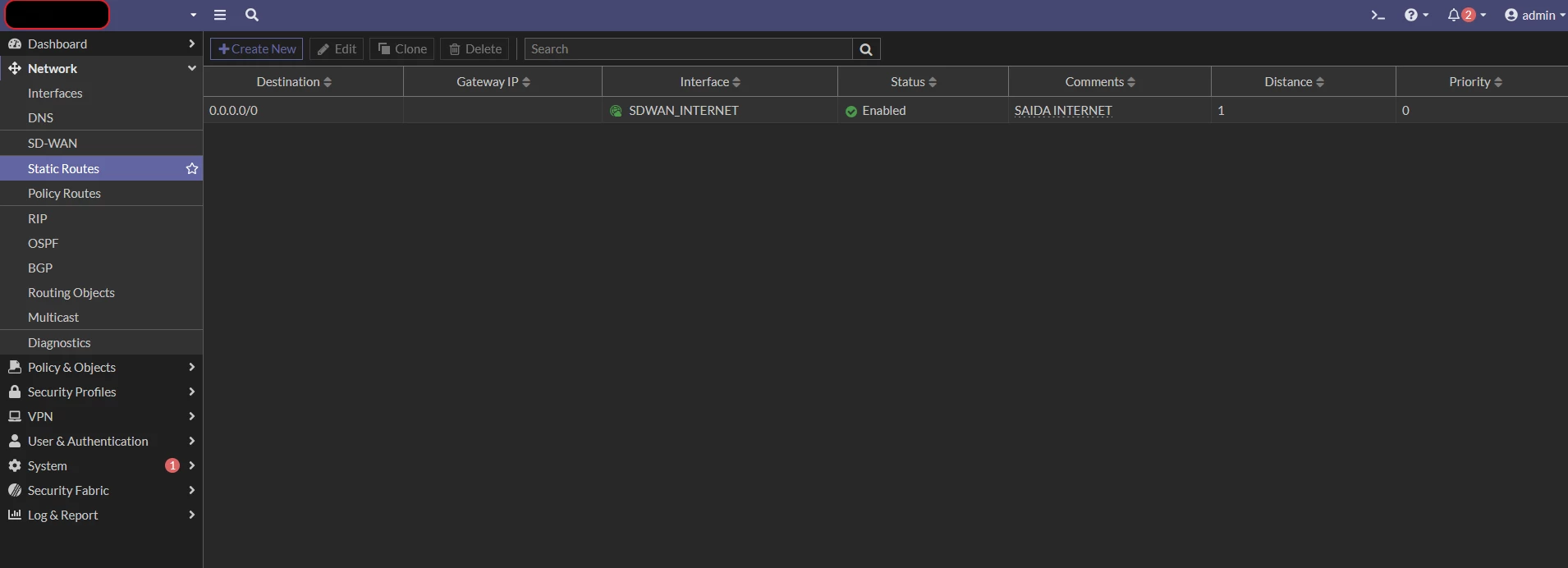

Screenshot of "Network > Static Routes"

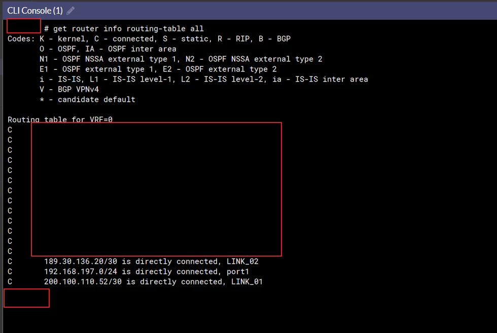

  • get router info routing-table all   (from CLI)

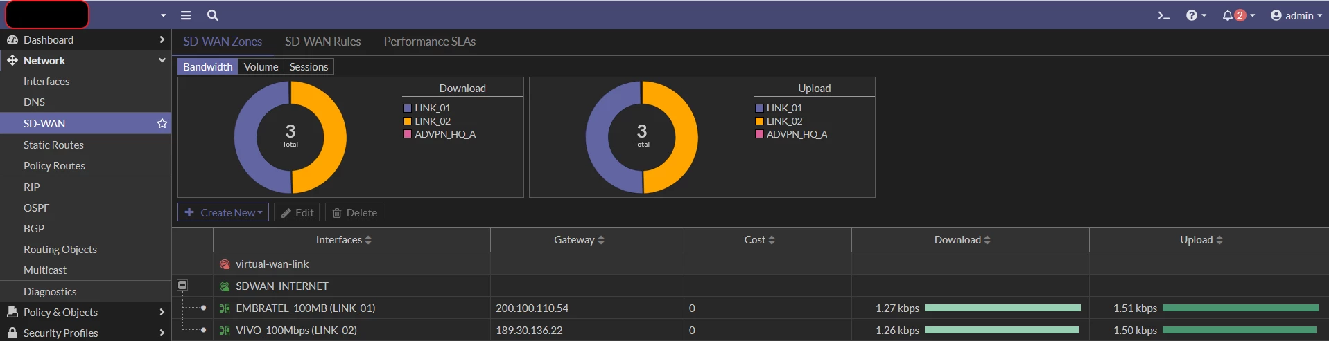

Then I guess this is a SD-WAN related issue, not a routing issue.

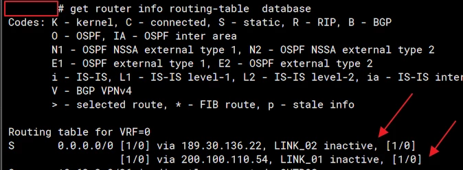

Hello, my problem is right on the route.
When you look, it appears as inactive
Why is this happening?

Hello Portinari,
If there are two routes to the same destination, the one with the smaller distance is considered better and used for routing.
The routes with higher distances are inactive and not added to the routing table.
If an interface is down, or FortiGate does not have Layer 2 connectivity to a subnet, that route is also considered inactive and will not be added to the routing table.
You can use the command which displays only the one with the lowest distance (the active one). :
get router info routing-table details x.x.x.x --------- replace the x.x.x.x with the destination IP address.
