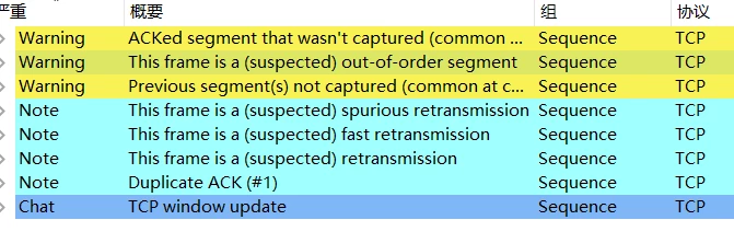

There were some packets had been lossed.I found a tip that explain how it happed.
When the the 3rd tcp handshake packet ('ack') get handle by CPU (slow path), the 1st data would already get accelerate by Network Processor (fast path) and will increase possibility to trigger TCP out of order between these 2 packets.
