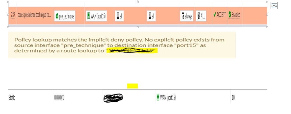

hello
i have a only one subnet that don't much with any ipv4 policy, when i check the router loockup i find the route to this subnet but when i use loockup policy to this subnet they much with poiciy id=0  knowing that i have policy from my vlan to wan with source set to any and destination set to any and all service are accepted
Best answer by emnoc
comon,It's not a bug in the fortigate it not fortios or hardware issue.,
If you'e hitting policy 0 and you think you have a policy that should have match and  it DID not, than your policy creation is flawed , or incorrect, typeo, wrong interface(s), wrong  address, wrong service ...pick one but your policy is NOT being matched and a reason exist as to why.
The diag debug flow  output kinda of tells you where your next step(s) are. Your screenshot attachment clearly tells you you have no match also.
You need to do some more work and correct the reason as to why the "the policy that you  'wrote' " is not working. It's really that simple.

Re-check and double check the network address and netmask on the interfaces involved. Even with a matching route (again: check address and mask) and a plain open policy a connection might fail.
You can debug that by using "diag debug flow" but my experience is that if you already know it's hitting policy 0 it will not give you any additional info.

Ede nalied it but yoru answer is in your screenhot. It sounds like the wrong interface pairs are not being matched.
Here's a trick I've been doing now for 14+ years. If you believe the src-dst-address and service is correct, change the policy src/dst-interfaces to "all" and test. If the traffic matches that changed policy, you know the interfaces are wrong.

thank you for all but i try  to use any interface in destination , all services but they don't work, and i already execute the diag debug flow but without any solution, i think that i need to restart the policy but i don't know how!!
i thnik this a bug inside fortigate.
