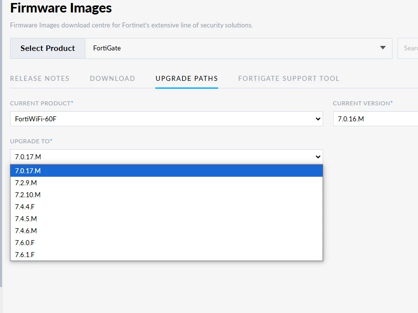

I got FortiCare today so downloaded some firmware off the site following upgrade path then the UI offered to do upgrades in the console rather than manual.
Now it is at v7.0.17 and the upgrade path tool goes up until only 7.0.16 so I don't know how to move up to 7.6.

It is safe to assume the upgrade path from 7.0.16 to 7.6.x is the same with from 7.0.17. Especially the 7.0.17 doesn't have many changes. Only two are listed now.

You are right. The upgrade path tool doesn't include the 7.0.17 as current version, probably because 7.0.17 is very new (released yesterday), so I believe Fortinet will correct the web page in the next few days.
On the other hand if you FGT is in production environment then I think you shouldn't upgrade to 7.6.1, but you should upgrade to 7.2.10, which is the version recommended currently by Fortinet.

It's not because v7.0.17 was new, upgrade from chronologically later (v7.0.17) releases to chronologically earlier (v7.2.10) releases is not supported. That's because those upgrade steps are not QA-tested. Upgrade v7.0.17->v7.2.10 or earlier should be considered similar in risk to downgrade or upgrade without following path, worst case is corruption or failure to boot.
If there are issues with unsupported upgrade often they are specific to the platform or configuration so unfortunately can't rely on it working once. If it's not urgent I would recommend to wait for v7.2.11.
Upgrade from v7.0.17->v7.2.10 might work, but it's not supported. If making that choice I would have no expectations and local serial console access in case booting from backup partition is necessary.

Sometimes, useful info you can only find in one place is wrong! v7.2.11 was released yesterday and v7.0.17->v7.2.11->v7.4.7 is a supported upgrade path despite breaking the rule of thumb I just gave (v7.2.11 released 2025-02-12, v7.4.7 released 2025-01-21). I think that would match most customer expectations too, apologies for misstating it.
To get more granular with this, in FortiOS upgrade from the latest patch in earlier Minor Version to latest patch in the next Minor Version is usually QA-tested and supported even if the target firmware image was released chronologically earlier. However this is is not always true and is in fact one of the major reasons for providing upgrade path information. v7.0.17 has no recommended path to v7.2.10.
One thing that's almost always true though- there is a cut-off for how early you can go in the next firmware version via supported upgrade paths. For example, v7.0.16 -> v7.2.9 is a supported upgrade path for most platforms. v7.0.16->v7.2.8 and earlier is not.
