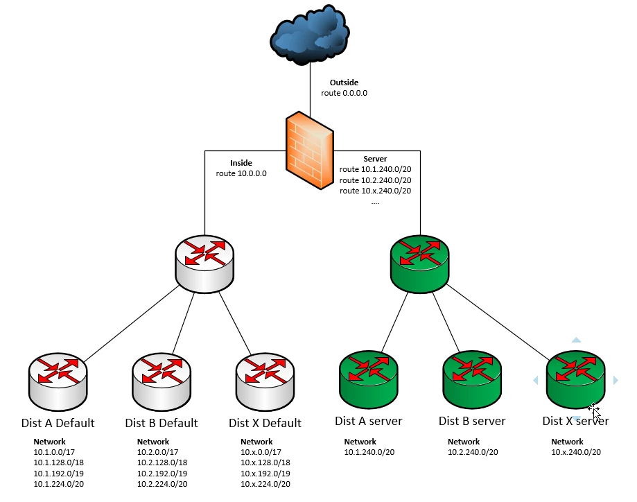

    You're right. My networking guy confused me about using discoutinuous mask. He was talking about ACL and not route. So here is exactly why I was asking that question at first. We have multiple distribution and each of them is using /16 subnet (ex, Dist A = 10.1.0.0/16 Dist B = 10.2.0.0/16). They are part of the default routing instance in cisco switch wich is connected to the inside interface of our Fortigate. Each of those distribution have a reserved subnet for servers (ex, Dist A = 10.1.240.0/20 Dist B = 10.2.240.0/20) which is part of a distinct routing instance (VRF2) in our cisco switch which is connected to the server interface of our Fortigate. Is there a way to create a single static route to point all those subnet to the server interface? That's why I talked about using discontinuous mask.

    Okay I don't quite understand, the /20s you listed are included in DIST-A and DISt-B, if they are not reachable via the same gateway just place the most specific entry/next-hop for these server instance.
    If you could draft a topology map, please do so. Keep one thought in mind tho;
    "you can't over-lap interfaces addresses in the same VDOM"

    I don't what your question is now. Your network topology looks ...well  great.
    You can't really summarize the /18s and larger. In your case the 10.0.0.0/14  would catch all on the left side and then your server distribution &  with  the 3x  /20s is all that you need. You can't install a  variable mask for these networks if that was your  original question.
    Ideally, I would have done some thing like install the server-farm  networks in let's say a 10.4.0.0/16 & skip the discontiguous  setup that you have all together. It's like you have to go to a  ARIN or equal to justify the utilizations ;) > Just something to think about.
    But like I said earlier. It (network) looks great and simple.
