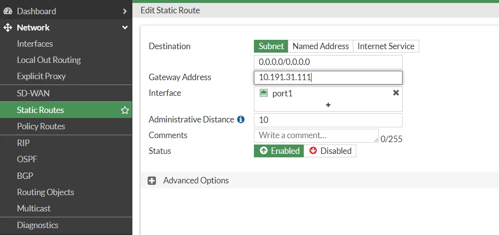

dbu
May 5, 2024
Hi @abbio90 ,
Your public IP should be on same network with the ISP IP.
1.2.3.4/32 and 192.168.80.1 gateway have nothing in common.
Maybe i missing something here.
Regarding the static route you can set like this from GUI :
Or from CLI :
config router static
set gateway 10.191.31.111
set device "port1"
