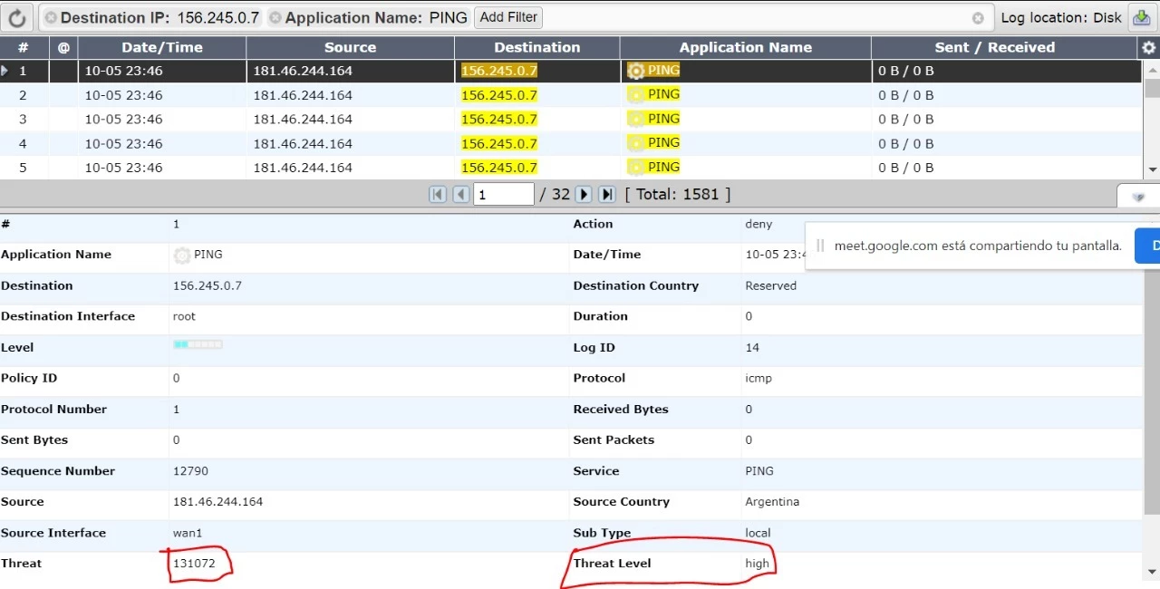

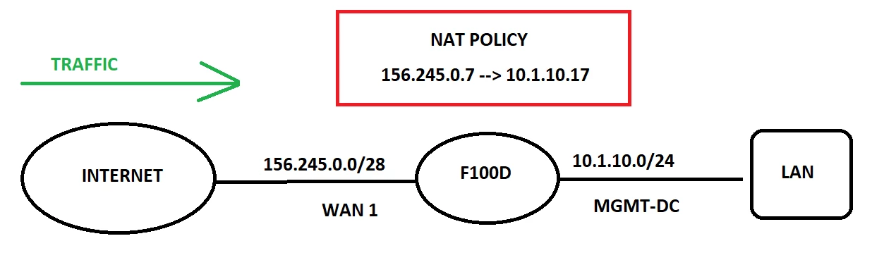

HI people,  im trying to implement a destination nat policy without success.
Im using VIP config and a policy allowing incoming traffic but the traffic is always blocked with thread 131072 message.
DIAGRAM:
MESSAGE LOG:

config firewall vip edit "NAT-IPERF-1" set uuid 86f995e6-17e9-51ec-e2cf-6bb4e9b41359 set comment "156.245.0.7 --> 10.1.10.17" set extip 156.245.0.7 set extintf "any" set mappedip "10.1.10.17" next end

    Agreed "NAT-IPERF-1" also if you looked at the log you would have seen you did not match any policy, hence policy id 0
    "diag debug flow" is your friend
